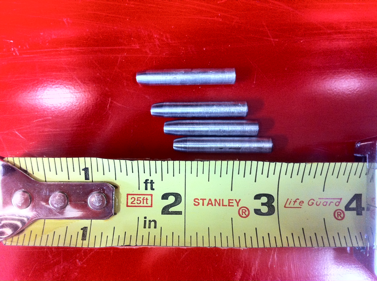

PostPosted: Tue May 31, 2011 4:54 pm    Post subject: Re: Quick Build fuselage (landing gear fittings) Reply with quote
Just did this a few weeks ago. When I noted that all of the QB bolts had torque seal BUT the landing gear bolts, the floors can't be removed without removing the landing gear, and I want insulation under the floorboards...I decided to remove the landing gear mounts. I It was very difficult to remove both gear mounts due to the incredible force on some of the bolts. You can tell that some bolts were doing 100% of the work and others were doing 0% (as evidenced by the pressure to remove and the surface cad lost). In the end, they came out with some damage to the bolt heads (from the plier used to grab and pull). A few bucks worth of bolts from Vans and I was feeling good about my ability to access the floors. No odd findings, but good access to verify everything and add insulation. I fabricated drifts out of the old bolts (see image attached) which my tech counselor said would be very helpful in aligning everything for reassemby. Reassembly is around the corner...so I'll let everyone know if it was more/less difficult then removal. In the end, I do not feel it is imperative to remove the gear, but no harm is caused by doing so.
 Filesize:  690.68 KB
 Viewed:  17933 Time(s)

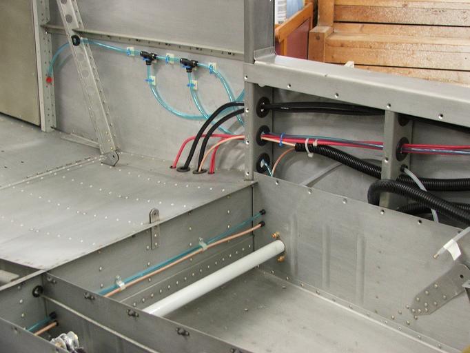

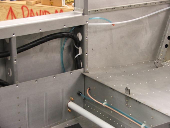

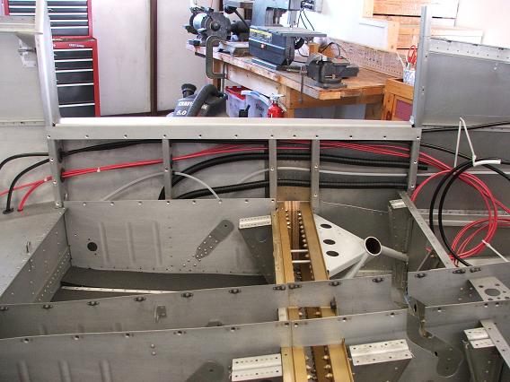

PostPosted: Thu Jun 02, 2011 6:28 pm    Post subject: Re: Quick Build fuselage (landing gear fittings) Reply with quote
David,
I couldn't recall which floor panels were installed with the QB and which ones I did. You are correct - there is no need to run anything under the front floorboards. I have run quite a bit under the rear seat pans and baggage floor. My comm antennas are attached on the belly just aft of the rear wing spar with the coax running forward just above the rear spar and then to the side panel (see photo).
There is plenty of room to run wires along the sides starting forward and running aft to the rear seat side panel. At this point my wires dive under the floor and emerge aft of the baggage compartment at the battery.
 Filesize:  61.81 KB
 Viewed:  17847 Time(s)
David,

PostPosted: Fri Jun 03, 2011 10:11 pm    Post subject: Re: Quick Build fuselage (landing gear fittings) Reply with quote
Dave, Thanks for the pictures. It's always nice to get the visual! Today, it was front floors but the baggage/rear floors are around the corner. I'm excited to get to the conduit. Thanks again, David
