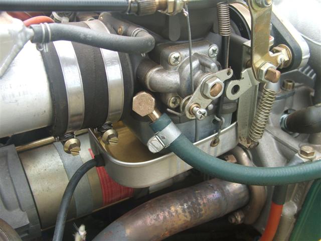

Yeh, sure do need heat shields for those carbies right above the hot exhaust. I used sardine cans. They fit really well, are light, and the price is right. They are a friction fit over the bowl of the carb, and an elastic cord or tie wire secures them. See photo.

Pretty clever !! I love sardines ! Think I will make a set of these. They look Good !
