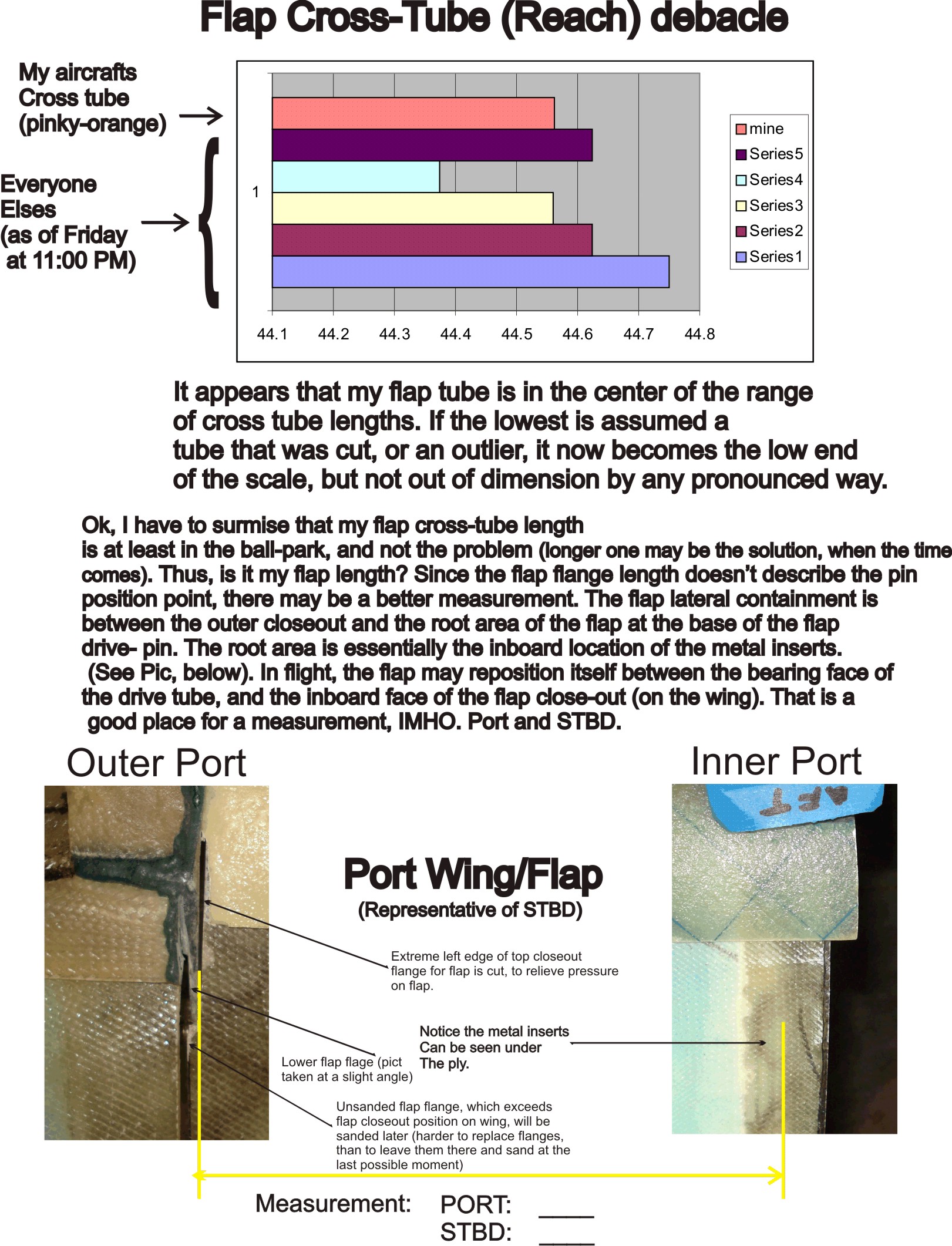

Now I am looking at flap lengths. Maybe a few more measurements will help
towards solving this puzzle. Flap lengths measured from flange to flange are
variable though, but If one measures from the outer flap closeout (on the
wing) to the drive plates (where the pin inserts, on the flap), I think this
would be helpful. This describes the would-be flap containment area,
assuming the cross tube butts up against it inboard, and the flap butts
against the outboard closeout at the tightest flap position setting. Easier
for those folks that haven't filled their wing yet, to see the plates
through the glass flange. See attachment for further detail...hopefully I
described it well enough as to make it understandable. I measured mine too,
but misplaced the paper it was written on I will have to do it again.
Greg
 Filesize:  672.83 KB
 Viewed:  3553 Time(s)

PostPosted: Sun Jun 05, 2011 9:08 am    Post subject: Re: Flap cross tube Reply with quote
Greg
My flap cross tube on kit 497 is 44.6 inches as supplied by Europa (untrimmed and without bearings).
My flap dimensions are shown below, measured from the closeout web between the flap and aileron and the inboard face of the wing pin mounting plates.
Port 1908 mm or 75.2 inches
Stbd 1912 mm or 75.3 inches
Hope this helps.
Kelv Weston
Kit 497
