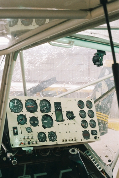

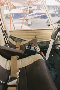

I did about the same: elevator trim, PTT, plus electric flaps via 4-way "China hat" switch (CH601 flap actuator motor under pilot seat).
Pic attached showing other mods to the cabin area.

I, like most probably many others, have been following this post to see how each builder solved the stick/wiring issues. I also compliment you for posting a photo, but please tell me why you include a photo so small, that none of the details are visible.

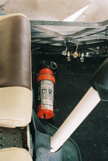

Here's two more pics, Robert: I hope that helps.
