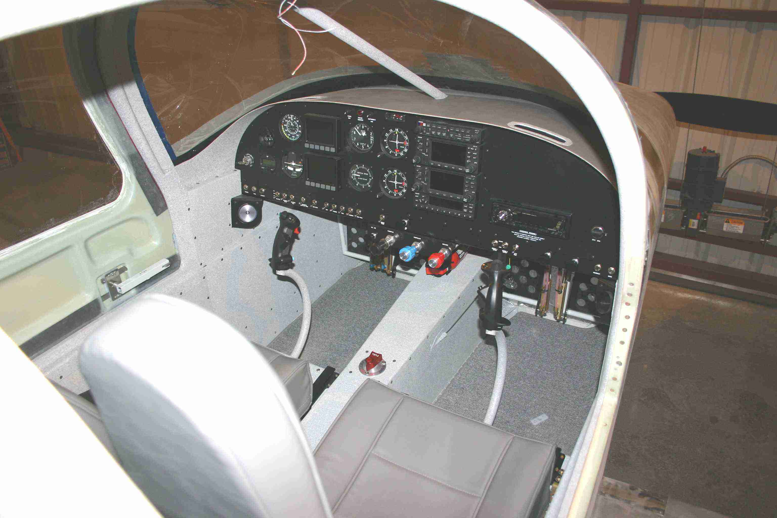

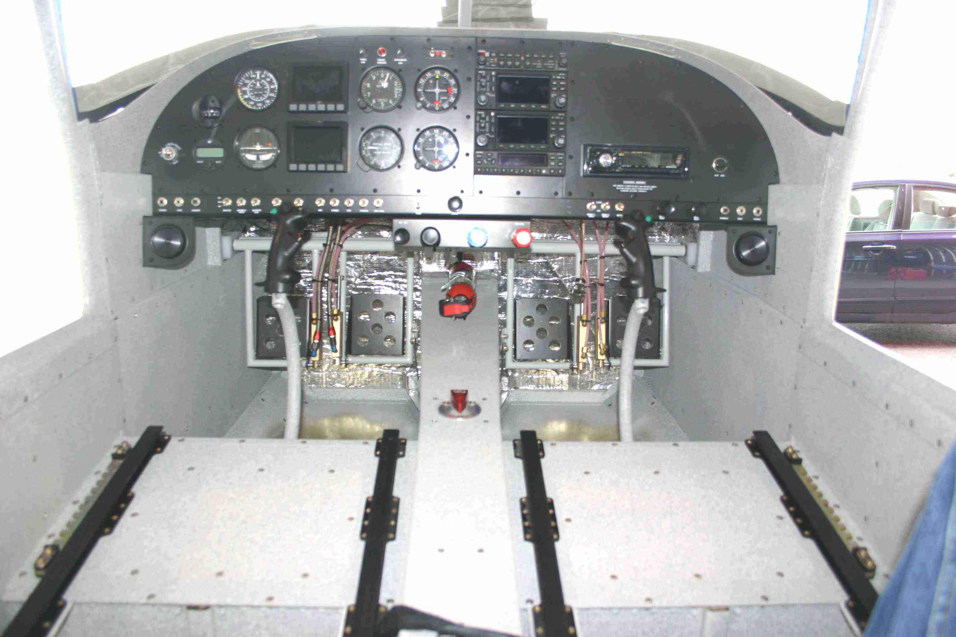

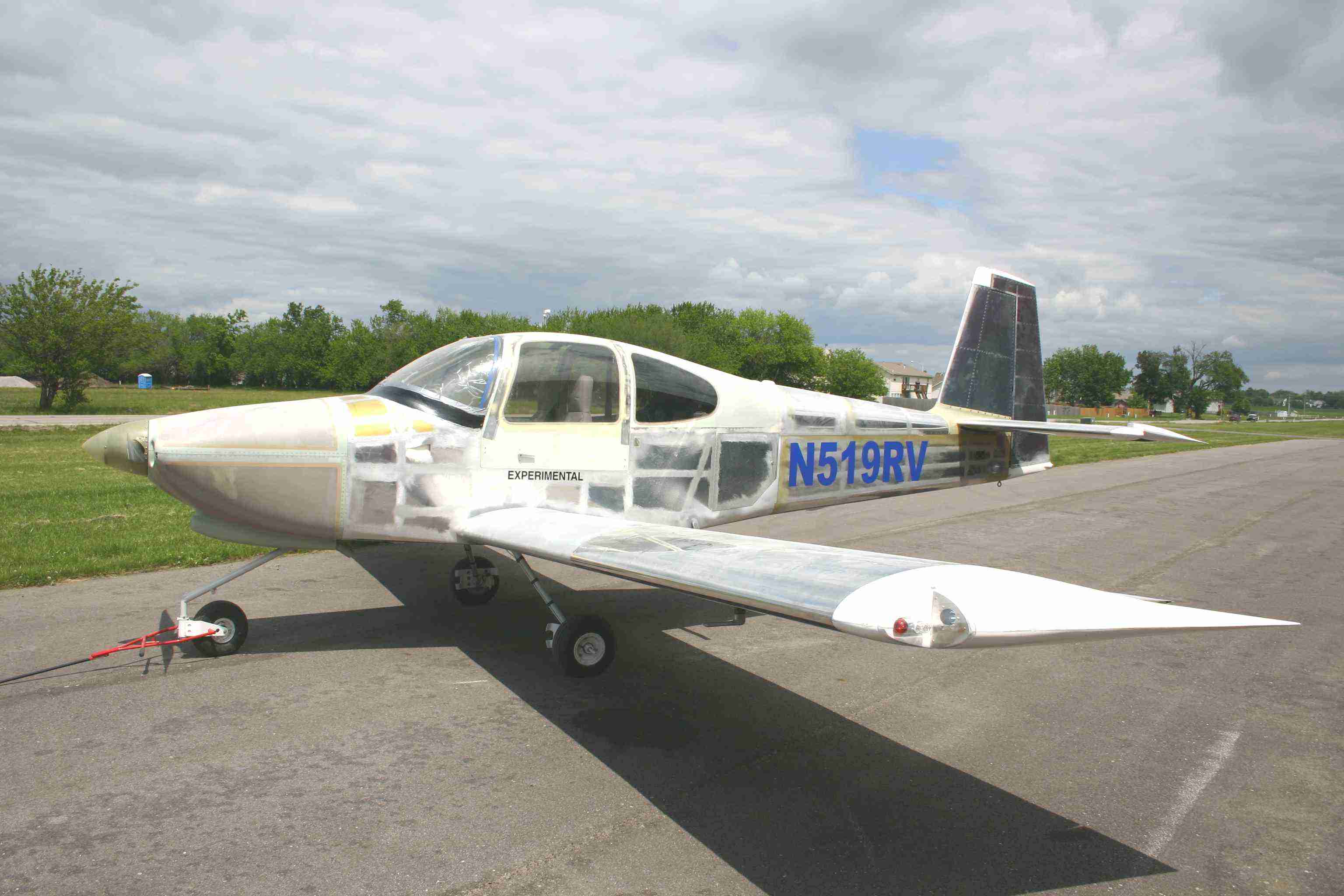

            Here are a few recent pictures of N519RV (40250).  I also completed the W & B yesterday, which weighed in at 1587 lbs.
            Nose Wheel      369 lbs              Arm      49.82
            Right Main         609 lbs              Arm      123.82
            Left Main           609 lbs              Arm      123.69
            For the Weight and Balance, the gear leg fairings, wheel pants and intersect fairing were not installed.  The exterior of the plane in not painted, but the interior is complete with carpet interior panels all painted except the insides of the doors.
Thank You
Ray Doerr
40250 (N519RV)  (DAR scheduled for Mon May 22nd, First Flight scheduled for Fri May 26th)

   Nice, clean looking interior.  Are the side panels painted aluminum sheet or vinyl  with snaps?   It’s kind of hard to tell by the pictures and I’m trying to firm up what I’ll be doing on the sides.

Could you post the part # / where you bought your tow bar? Aircraft Spruce sells a bunch of them, but I'm not sure which one works with the RV-10

            I made the panels from .020 aluminum sheets.
