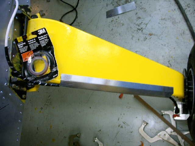

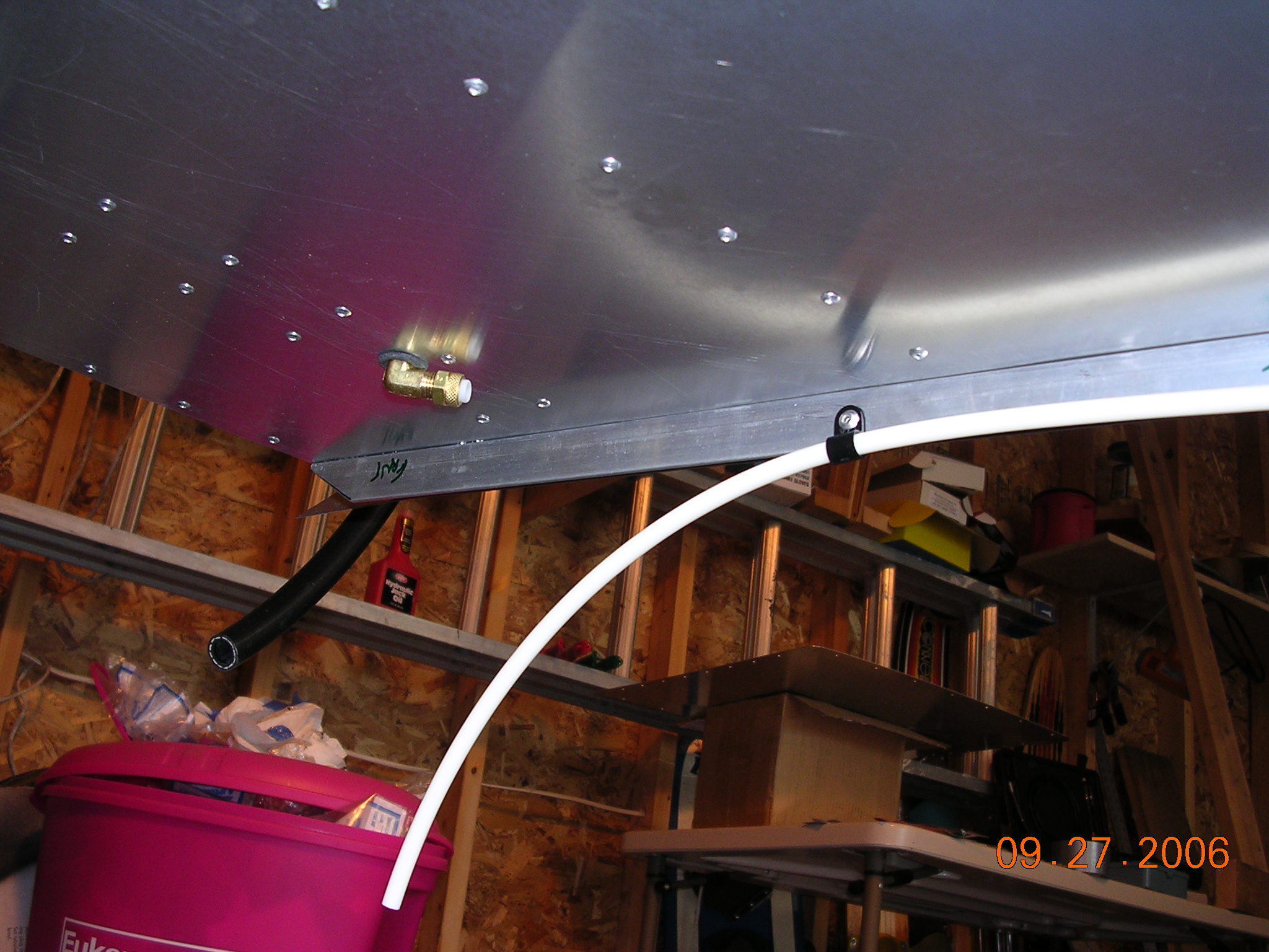

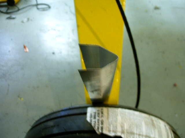

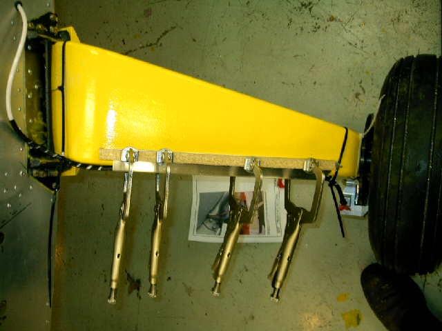

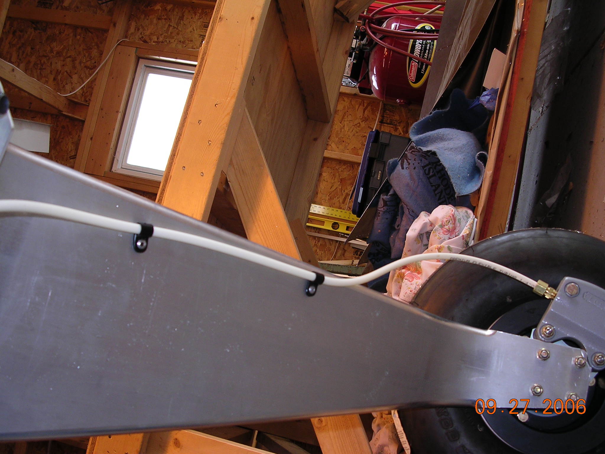

rgeese
Joined: 16 Aug 2006
Posts: 19

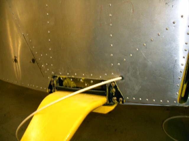

PostPosted: Mon May 30, 2011 5:24 am    Post subject: Re: brake lines with dual sticks Reply with quote
Hi Chris,
I know this is not what you were wanting, because I ran them outside the fuselage, but I wanted you to see my photos of the installation.
I store all my construction photos at this site:
http://cid-2c08001814b26710.photos.live.com/browse.aspx/Ron%5E4s%20601XL
The brake line installation photos are numbers 278 thru 287.
Hope this helps.
I'm not flying yet, so I can't give you an "operational report". I'm still working on the mandatory updates. The fuselage is done, and I now have the first wing torn apart.
Ron Geese
Reynoldsburg, Ohio USA

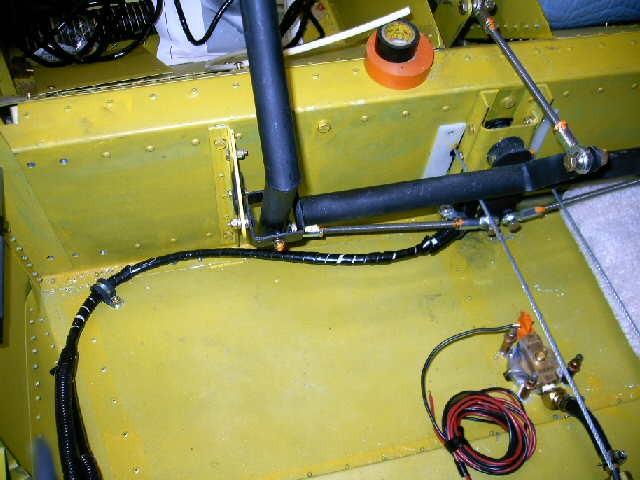

tonyplane(at)bellsouth.ne
PostPosted: Mon May 30, 2011 7:24 am    Post subject: brake lines with dual sticks Reply with quote
Attached for info. from build photos. hope they come through.
Tony Graziano
N493TG
