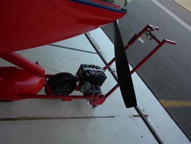

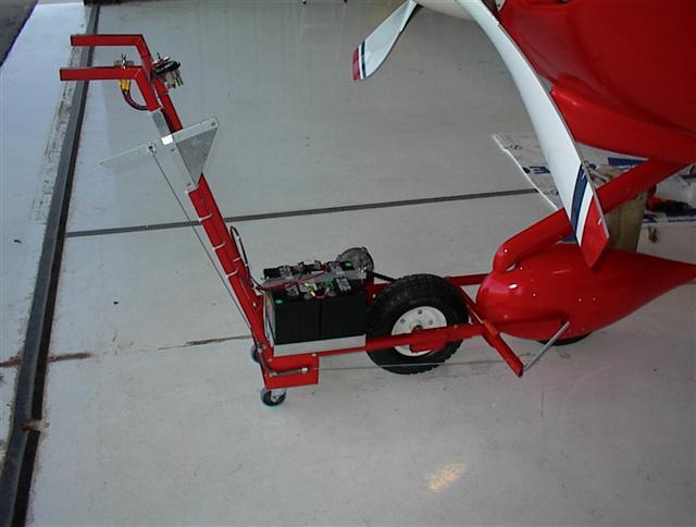

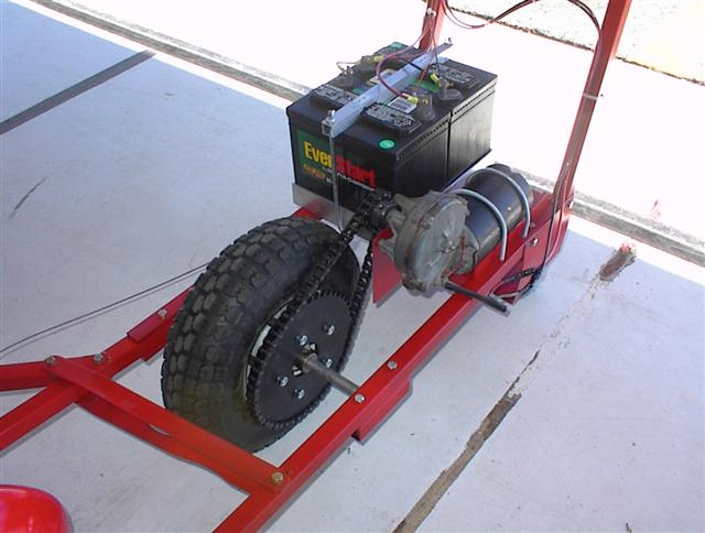

I built my own based on an article in Kitplanes called something like "Build
a tow Bar for $10". Mine ran more than that, got the tires with bearings
from Harbor Freight, a friend gave me a 24V gearmoter, batteries from
Walmart and the 1" square tube for the frame from Lowes. The 24V motor was
nice as it gave me 2 speeds. An over-center link keeps it clamped to the
front wheel. I've since added LED lights for night use. About $150 I think.
The Kitplanes article guy used a windshield wiper motor and made his own
sprockets.
Albert Gardner
N991RV
Yuma, AZ
(A wench to operate is extra)
