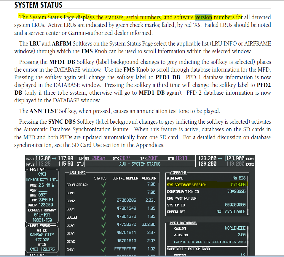

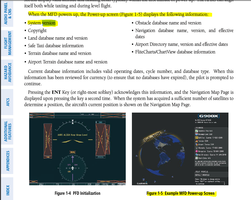

I have a 900x and can't seem to find what version of software I am running.
I think I uploaded the latest version but can't tell for sure.
Where in the menu do you find that info?

Gary,
Here are some snips from the manual. I believe on the system status page
(not sure the exact name of the page) it also shows the version number.
If you have not updated the system recently Garmin released version 09 on
4/5/2011. I think version 08 was released very early in 2011.
