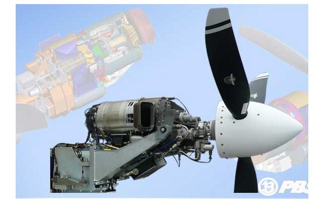

If our Europas would only have a bigger tank, I would prefer this:
http://www.pbsvb.com/dlt_motor_tps100.php
Or has somebody build wing tip tanks already? Smile
