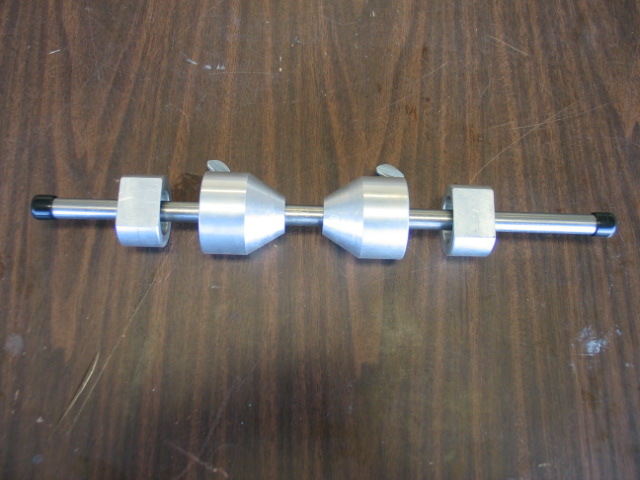

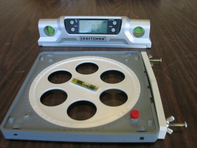

Here is a picture of what you can use to get good accurate prop pitch settings and uniformity. Here is another picture of a good prop and wheel balancer from Marc Parnes.

prop pitch tools
