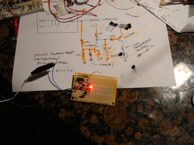

  I've got a perplexing situation, and for the life of me, I can't seem to figure this one out.

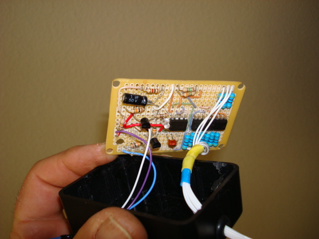

  I built the Dynon alarm circuit that Bob N. designed last year.  I also combined it with a strobing
LED circuit later.  On the bench (kitchen table),the whole thing works PERFECT.  No flaws...no
hiccups, hook up all the right wires, and the LED comes on when it's supposed to! (see the
enclosed circuit diagram & photos)
(Note:  Bob sent me a slight revision that added a 10K resistor and test wire not shown in
his original design.  It branched off the node between the two 10K resistors and base of the 2N3904)
(Second note:  the photo of the completed circuit I built didn't have the green wire & 10K resistor
for the test function, yet.  You will also notice in this photo I added a 555 timer/4017 cascading LED
circuit which is tied in together with the alarm circuit LED.  Works perfect on the test bench as designed,
no problems!!)

PostPosted: Tue May 31, 2011 5:44 pm    Post subject: Dynon alarm circuit revisited Reply with quote
Here’s a possibility:
When idle, it’s possible that the Dynon alarm tone output is high. This turns on the 2N3904, which discharges the capacitor and turns the LED on briefly. When the capacitor charges up, the lamp goes off. At this point, your test input will have no effect because the 2N3904 is already on.
The fix for this would be to put a capacitor in series with the Dynon output. That way, if the the Dynon tone is left high, it will allow the 2N3904 to go off and let the test lead operate.

PostPosted: Tue May 31, 2011 6:36 pm    Post subject: Dynon alarm circuit revisited Reply with quote
Vern,
Thanks for the reply. No, the Dynon alarm tone is not always 'high', since it's true and original
function is to hook up to your intercom, and alert you if there is an AOA alarm. A constant high tone would
give a continuous loud screaming alarm in your headphones. Besides, if it were on (high), as
soon as I hooked it up, the circuit would activate. THAT part of the thing seems to work ok.
Bob simply tapped off the intercom alarm signal wire and designed this circuit, which will then allow
for a visual alarm, in addition to the audio alarm.
It's a darndest thing!!! You only have four wires....it's not like there's much to go wrong!!! Purple wire gets constant +12v,
white goes to GND bus bar, green wire is the 'test' wire, & lastly, the light blue wire is the Dynon. Whether I hook up the
circuit in the house, or hook it up in the plane, it's awful simple. In the house....it works, in the plane...it doesn't. The ONLY
difference is that the power and grounds are different, but the hookups are pretty much the same.
BTW, regarding your suggestion; if the circuit is in the plane, and I unhook the Dynon wire from the Dynon, I CAN hook up
a simple alligator clip wire from the +12v instrument bus to the light blue Dynon wire, and everything is great. Works like champ!!
But, when I try to do the same exact thing (+12v to the green test wire)....nothing. Take it into the house, hook it up.......and it works!!
Beats the heck of me what's going on!!!
Thanks for your thoughts, Vern.
Mike W

PostPosted: Tue May 31, 2011 9:19 pm    Post subject: Dynon alarm circuit revisited Reply with quote
Hi Mike.
Then I think that the output of the Dynon is bipolar (+ to – voltage) so that when the tone is off, it’s biasing the 2N3904 base voltage so low that your test voltage is not quite enough to overcome this bias. This may be why it’s sensitive to the voltage on the test input. Simply changing the test resistor to a lower value will fix that (4.7K).
But, when I try to do the same exact thing (+12v to the green test wire)......nothing. Take it into the house, hook it up.......and it works!!
Mike W

How about showing us the whole schematic as-built?
Also, one of your observations invites a second look.
If a 10K resistor burned out in a 12V system, then EITHER:
It wasn't really a 10K resistor, since 12V and 10K makes
about 14 milliwatt power dissipation, which means no burnout by
any kind of failure in a 12V system. OR somehow you got
quite a bit more than 12V into your test.

Hi Mike,
  Regarding the burned out resistor, a while back when I was first installing the
whole circuit, somehow I got a 24" long jumper wire hooked up wrong!!!
When I turned on the ignition switch, it started burning and melting & losing
lots of magic smoke.  I quickly yanked it out of the plane!!
  Thinking I really screwed up big time, I took the box out of the plane, took
it back inside the house and hooked it up.  Everything works great!!
  Where, or how that 10K resistor got burned out, I don't know.  Yes, it was a
10K, I still have it.  Yes, I replaced it with a 10K.  I've even checked both of the
resistors for their accuracy (for the light blue wire & green wire).  9.84K for the
green, and 9.84K for the light blue.  One works perfect, one doesn't.
  I'll see what i can do about posing the whole schematic.  It may have to come
as two complete circuits.  (The one I just posted is the alarm part of it)
Mike
