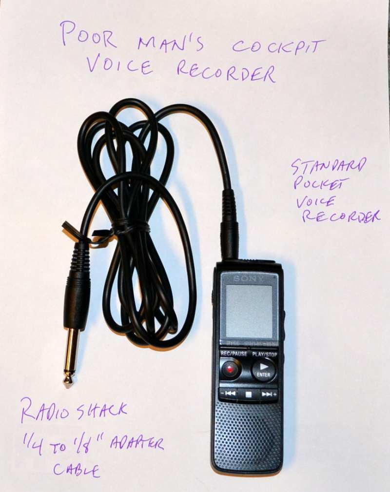

While thinking about flight test on my XL I have been trying to come up with a neat way to record data. The recent NTSB report on the crash in Alaska brought the idea of a cockpit voice recorder to mind. I'm sure the ones used by the airlines are more expensive than a whole Zodiac, but I tried to come up with a lower priced alternative.
It is a normal pocket voice recorder with a cable to plug it into the headset jack intended for the copilot. Since there will be no copilot until phase I testing is completed this is a "Free" jack for attaching the recorder to the intercom.
I don't know if it will work well yet, but here it is anyway for everyone to take shots at . . .
Paul

PostPosted: Wed May 25, 2011 3:02 pm    Post subject: Poor Man's Cockpit Voice Recorder. Reply with quote
<?xml:namespace prefix="v" /><?xml:namespace prefix="o" /><![endif]--> No shooting from here; it makes good sense. You may also want to think about a small video camera to mount over-the-shoulder, to monitor your instruments while doing the Vx, Vy, stall speeds and such. Could also be helpful in correlating engine temps with flight regimes.

Hi Paul,
I considered some kind of video recording device as well as the voice option. Actually the voice option just came to mind.
Video might be nice, but the voice recorder seems very simple to install and also to use after the recording is made. I really only want performance data and I can "Talk to myself" with the intercom to record things like stall speeds and other critical airspeed data. Video would make a better recording to share with others, but I really want to find a nice way to record data without using a pencil and paper. I just don't have enough hands to fly and write at the same time and I don't think the trim on this very light plane will fly it well enough so I can ignore it for the time it takes to write down data.
I tried to insert a picture of my recorder in the first message and it didn't take. I'll try one more time:
[img]cid:part1.04080400.05050904(at)att.net[/img]
Paul

rsteele(at)rjsit.com
PostPosted: Wed May 25, 2011 5:29 pm    Post subject: Poor Man's Cockpit Voice Recorder. Reply with quote
I've heard of people putting a small mic inside the ear cup of the headset.

jlatimer1(at)cox.net
PostPosted: Wed May 25, 2011 6:39 pm    Post subject: Poor Man's Cockpit Voice Recorder. Reply with quote
Paul,
You could also use the same arrangement with a video recorder. Just plug the headset into the mic input on the recorder or do as someone else suggested place a small mic in your headset.
I used a video recorder and found it to be super useful. I made suction cup mounting device from a dent puller from Harbor Freight. I found the plans on the Internet was able to bring the video home and refly the entire flight while watching all instruments. Using Windows Media play I was able to play the video and get super accurate times for ROC data. These are much more accurate than you'll get with a stop watch in the airplane.
My 2cents
Jerry
601HDS, 912, 94 hours, first conditional completed.

psm(at)att.net
PostPosted: Wed May 25, 2011 7:27 pm    Post subject: Poor Man's Cockpit Voice Recorder. Reply with quote
Hi Jerry,
If you plug your headset into the video recorder then how do you talk on the radio?
Paul
PostPosted: Wed May 25, 2011 8:08 pm    Post subject: Poor Man's Cockpit Voice Recorder. Reply with quote
You plug the the audio input of the video recorder into the copilot's headset jack with the intercom on.
Jerry

psm(at)att.net
PostPosted: Wed May 25, 2011 8:25 pm    Post subject: Poor Man's Cockpit Voice Recorder. Reply with quote
OK, I get it.
Same trick, different type of recorder.
Paul

Terry Phillips
Joined: 11 Jan 2006
Posts: 346
Location: Corvallis, MT
PostPosted: Sat May 28, 2011 6:30 am    Post subject: Poor Man's Cockpit Voice Recorder. Reply with quote
Paul
I'm with Jerry on this.
My CFI Velcroed a small video camera on the ceiling of his C150 and recorded flight lessons on a 12V VCR. Now-a-days, digital recording on a laptop would be better. The recording included the headset sound signal, so I had a complete video record of every flight. The camera showed the view out the windshield as well as most of the instrument panel. To compensate for the difference in brightness between the windshield and the panel, he attached a gray filter over the top half of the lens. The resulting videos were very helpful to me when I later reviewed each lesson. The panel wasn't quite readable in the videos, but it was not difficult to interpret the steam gauge readings.
I plan to use a similar setup when I get to phase I testing. You can also use the laptop to record all the data from an EFIS. Someone has written a program to handle that job. Google can probably find a link.
Tinker around a bit and let us know how it works.
