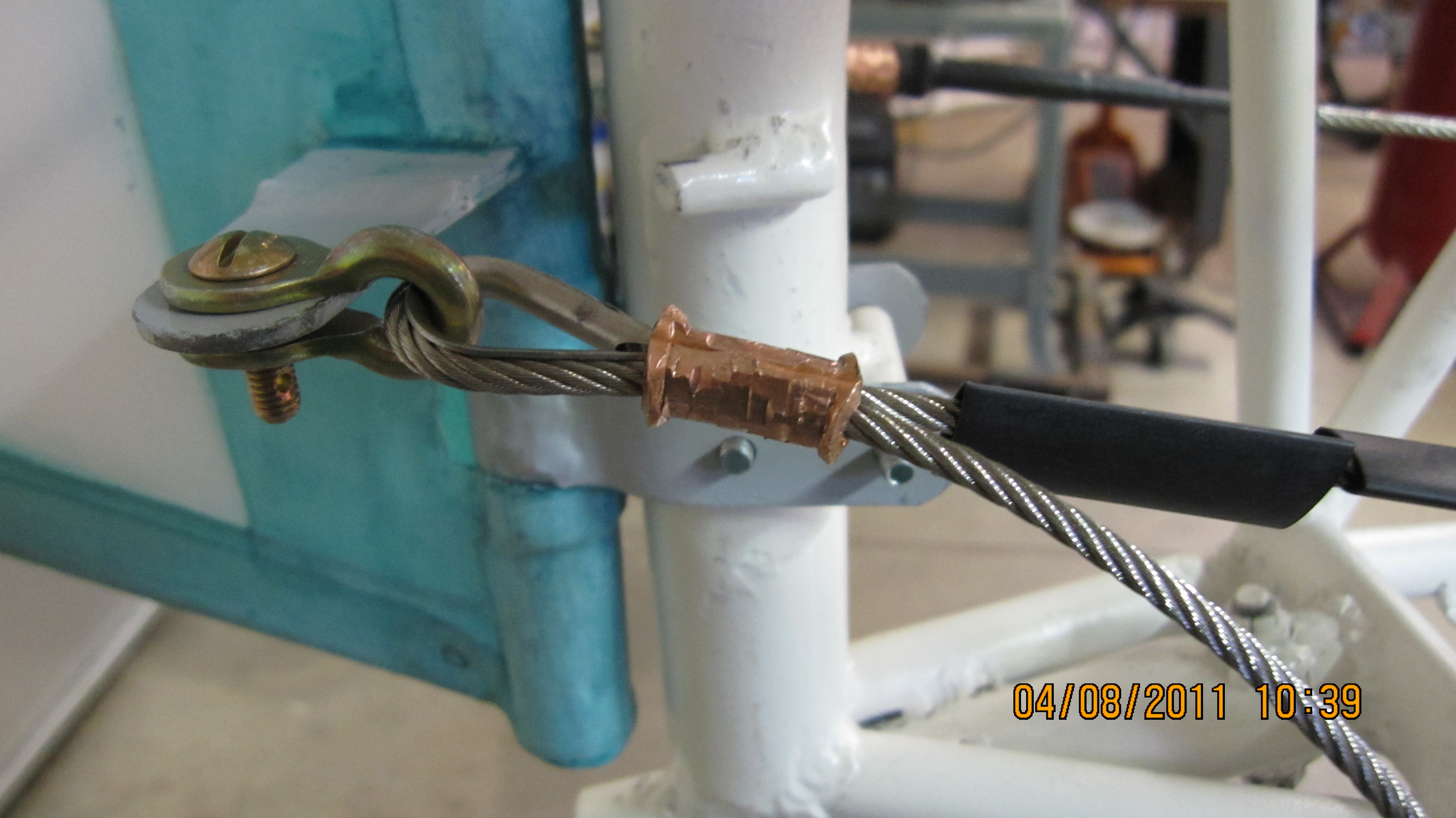

PostPosted: Wed May 25, 2011 5:24 am    Post subject: Re: Harbor Freight Hydraulic Crimper Reply with quote
I read the comments from others and saw a tip that said the HF crimper works for wire rope. So, I used it on my rudder control cables. Although the crimps are not as pretty as those from a genuine Nicopress crimper, it is a lot cheaper than a Nicopress crimper and a lot easier to use than a manual crimper.

PostPosted: Wed May 25, 2011 8:58 am    Post subject: Harbor Freight Hydraulic Crimper Reply with quote
Unless you did tests to establish that the resulting swaged ovals will take the full breaking strength of the cable take them off and throw them away. Your life will depend upon those cables. Is your life only worth the few pennies you saved? You can get a nico press tool for less than the cost of the HFT hydraulic tool. Your local EAA chapter surely has someone who will make proper cables for you, too. This isn't about pretty crimps, this is about providing adequate structural strength of a life critical component. If you're near central Kansas, I have a CGMP tool and a CG, too. I'll do the crimps for you. If you aren't near, send me the cables to me and I'll duplicate them with correct crimps for the price of materials.
Contact me direct if I can be of service.
Richard Girard

PostPosted: Fri May 27, 2011 4:48 am    Post subject: Re: Harbor Freight Hydraulic Crimper Reply with quote
Richard,
Thank you so much for your thoughtful opinion and generous offer to redo my work. I can see you are worried and can relieve your concerns. First, the crimps pass the go-no go gage. Second, the picture should show you the work is solid.
Thanks again for your concern.
