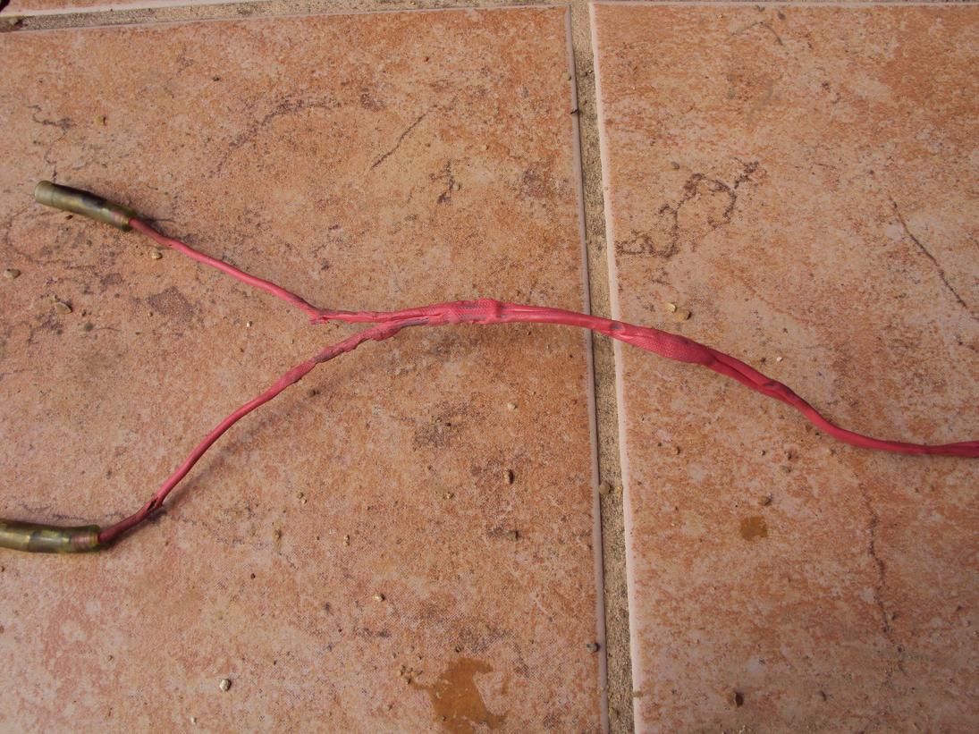

My 912 stopped charging, and when I checked the yellow cables from the stator, they were fused together. I soldered new cables on. After I replaced the yellow cables, the charging worked fine, but then it only fired on one mag. I then checked the cables from the stator to the ignition box, and found them to be fused together. The insulation on them was soft and could be pealed away with a finger nail. I changed them too, and will keep an eye on them. I believe rotax had a recall on these stators 10 years ago. Attached is a picture of my red cables

You might want to check the output of the dynamo (alternator) and use a scope to see if your regulator is failing and allowing AC into your system. Have you noticed any battery charging issues? Is there anything else on this circuit that could be drawing a lot of amps and / or shorted? Whatever caused it certainly let the smoke out of the wires.

Did you recently de-grease or wash the area with solvent of some kind? Rotax told me years ago that
that was the cause of the problem.
