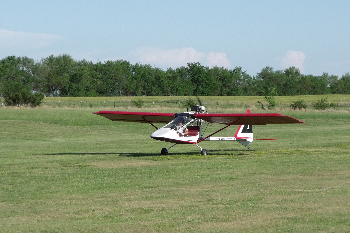

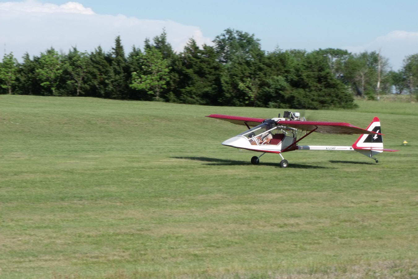

After months of work I took Ken's IIIX around the pattern three times this evening. Very nose heavy on the first flight so I adjusted the horizontal stab down one hole for the second two. Still nose heavy so I will take them down to the bottom hole if I fly it again tonight. Didn't try the flaps or do anything but take it off, around the pattern and full stop landings. So now I've flown a IIIX. Pretty Cool!

Jimmy, I'll try to keep it to a novella. The leading edge of the horizontal stabilizer was damaged and had to be replaced and the stab recovered. The front of the left stabilizer was mounted almost a half inch higher than the right and had to be lowered. The tail wires were slack and poorly made, I made new. The builder had strung the lower wires to the tail wheel bolt instead of its own bolt in the rudder post. The rudder hit the left elevator but had 6" of clearance on the right. The engine uses an "E" gearbox so it had been raised up almost 4" for clearance between the starter and the rear spar carry through. I made a new engine mount plate to move the engine back 5/8". The engine is now 5/16" lower than called out for the 618 with the "E" gearbox in the plans for the IIIC.
The forward plates of the main spar carry through on the fuselage were wallowed out to greater than 3/8" X 5/16" so I worked them out to be straight with the hole in the rear plates and enlarged them to take a 3/8" bolt. I still have to make inserts for the forward holes so the bolt will have 100% contact.
I replaced the Rotax radiators, whose mount was broken, with a Honda Sabre radiator.
There were a half dozen or more smaller issues and fabric patches but that covers the majors.
After talking with Bryan Melbourne yesterday about the incidence angles of the wings and tail, I was convinced that I need to weld up the holes in the spar tabs on the wings and redrill to bring the wing AOI down almost a degree. He has seen the "lawn dart syndrome" before caused by that wide platypus nose. I can see the nose cone caving in as speed comes up in level flight, so I believe Bryan is correct.
As it stands, performance is nothing like my IIIC. My C leaps off the ground with half flaps and climbs like the proverbial homesick angel. I have to horse the X off the ground after a long take off roll and it climbs very slowly. I've not reached pattern altitude on any circuit, but I haven't kept climbing all the way to abeam the runway threshold, either. I also haven't pushed it. While it's nose heavy I don't want to get anywhere near a stall. Although I've been trying to roll it on when landing I've landed tailwheel first 4 out of 6 times. Not hard, but I can feel it. The landing roll is long, too. When I lowered the stabs to their lowest position I felt confident enough to try a notch of flaps on approach. It helped a little, but until the pitch stability is fixed I won't use them again.
My opinion is that this is a good aircraft that was very poorly built. Fortunately it can all be fixed.
