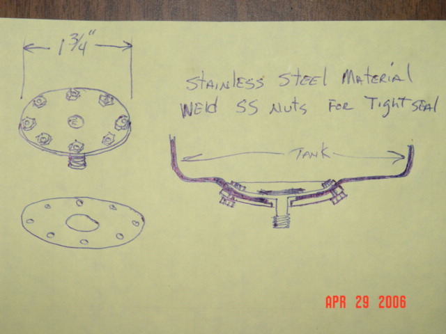

PostPosted: Sat Apr 29, 2006 8:15 am    Post subject: Fuel Tank Gasket Material ? Reply with quote
Hey Guys,
I'm going to make a couple fittings for the bottom of my fuel tanks...
( see "rough" sketch below )
The two pieces of Stainless steel will be concaved to make a low point
in the tanks... this way I can put a gasolator and drain and fuel pick-up at the lowest point of the tanks ( I might add a "site gauge" too )
My question is...
What are some good Gasket materials....Both Hard & soft ?
Gotta Fly...
Mike in MN
 Filesize:  61.37 KB
 Viewed:  417 Time(s)

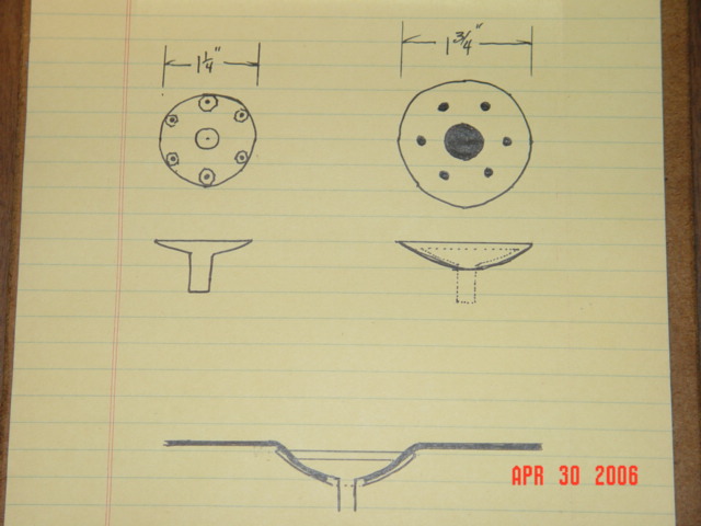

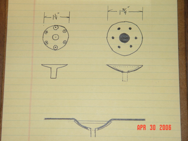

PostPosted: Sun Apr 30, 2006 5:30 am    Post subject: Re: Fuel Tank Gasket Material ? Reply with quote
I've revised my sketch...I'm thinking of making the "inside piece" slightly
smaller to force the curve a little better....
I'm thinking of going with "thicker" material and just tapping the holes
instead of welding nuts on (TIG)
Gasket seal ????? Hard , soft , silicone stuff ???
Gotta Fly...
Mike in MN
 Filesize:  60.5 KB
 Viewed:  398 Time(s)

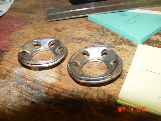

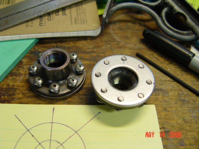

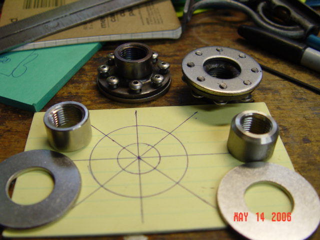

PostPosted: Sun May 14, 2006 11:29 am    Post subject: Re: Fuel Tank Gasket Material ? Reply with quote
Hey Guys,

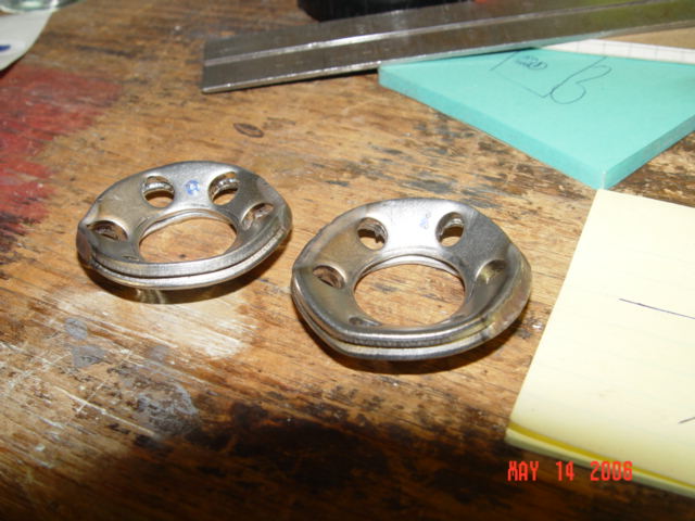

Here's a few pictures of what I've got so far....
I didn't like the way the concave seal was turning out...
So I went for flat Washers.... I'm gonna "groove" them later to get the
Fuel pick-up as low as possible....
I also went with 8 screws instead of 6....
BUT.... I "STILL" am looking for some kind of gasket material that can be
used with gasoline.....The Silicones that I've read say "NO Gasoline"
I'm wondering about cork....?
Well,
Here's a few pictures...
Gotta Fly...
Mike in MN
I'm using all Stainless Steel Material
 Filesize:  59.77 KB
 Viewed:  437 Time(s)
 Filesize:  60.85 KB
 Viewed:  396 Time(s)
Quick attempt....Checking possibilities.....( Didn't like it )
 Filesize:  59.99 KB
 Viewed:  386 Time(s)

Cork's good...

Hi John,
Those fittings were talked about before....what we didn't like about them is they don't drain "all" the fuel / water / debris ...
They stick up from the bottom of the tank aprox 3/8"
I'd rather just put a gasotator on to filter and Drain/Check the fuel/water....without anything accumulating in the tanks....
