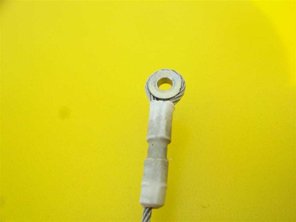

Non-Kolb related, but I expect somebody on the list can give me some useful info, so please bear with me and help me out.
Yesterday a friend and I went to look at a Kitfox that is being prepared for inspection and flight, and I was baffled by these cable end fittings. Years ago I saw another Kitfox that used these same cable end fittings for the rudder cables, one of them came loose and the pilot had a nasty ground loop and took the gear off it. Now I see them again on this airplane, so apparently Kitfox likes them, but I don't. The builder has done a good job, they were in the cable loop extremely tight with no give, but still - they just don't seem right to me. I don't like them.
So my question is: is this an acceptable way to do cable end fittings? Does anybody else have any experience with these little round barrels with a groove in them? Feedback? Is this actually an approved part or way of doing things?

Richard- I have seen that type used on an Elgin street sweeper, to pick up the gutter broom. No trouble with them, but they were a lot bigger. Maybe the Kitfox didn't have a big enough washer on it?

Bill, I like the street sweeper idea. How about a runway sweeper?
That looks like some kind of an electrical connector with grommet on the end.
Coincidentally I recently started replacing my tail wires. I went the stock route with 3/32 galv cable, copper nicopress.
I bought a dandy (and priced right) swaging tool from Home Depot. Just the right width to make two squeezes on a
3/32" sleeve. I hesitated but then went with two sleeves after reading about Rich Pike's screwdriver incident in the archives.
Maybe the groundlooped Kitfox didn't squeeze the sleeves sufficiently? Still, I would go with our old accepted method.
BB

Richard P/Gang:
You talking about the sleeve or the round cable thimble?
For cables, I would use nothing except authentic nicopress sleeves.
The round cable thimble...I use them on my tail wires. The work much better
than the normal cable thimble when mating with a tang.
Richard Pike

I'm talking about the round cable thimble, and I can see them working fine for something like tail wires. My Easy Riser used them for both flying and landing wires, but in both your situation and the Riser, they do not move, so are not subjected to any twisting loads that might slide the cable around the thimble.
The application that Kitfox uses is for rudder cables, both at the rudder end and at the pedal end where they have to pivot, and are constantly subjected to twisting loads. It seems that in that application, eventually the cable will start to pivot around the thimble. That is what concerns me.
Richard Pike
MKIII N420P (420ldPoops)
PS: How do you mate them to the tang? An AN-3 bolt? Got a picture?

Yes...made a fork with 3/16 washers/bolt/nyloc and an additional tang.
Thanks.
Richard
Challengers use this type of termination on the cables inbetween the landing
gear legs. The fellow who checked me out years ago in his Challenger, said
his failed regularly. He built a fixture and made them up in mass. I
suggested to him that he not slide the nicopress quite so close to the the
collar it would help releave the stress by trying to make a right angle bend
in the cable. He said he was afraid the cable could pop off the collar. I
countered with the suggestion that he add a fender washer to keep the cable
in place.
I know the landing gear puts much more stress on the cable than would a
rudder cable.
On my mod to stiffen the FireFly landing gear, I made my own ferrels out of
aluminum tubing. So far no problems.
Jack B. Hart FF004

AN111 cable bushings (pictured here) are allowed per AC 43.13-1B, paragraph 7-147, as illustrated in figure 7-12(c).
