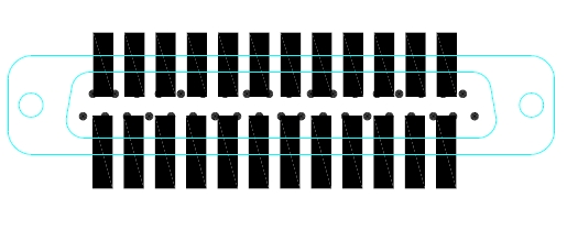

There might be a better way. I'm assuming you've got
12 upper and lower ECB tabs on a 1/16" thick board.
[img]cid:7.1.0.9.0.20110518014123.01db35d0(at)aeroelectric.com.0[/img]
Here's an AutoCAD plot that shows the alignment
(or lack thereof) for .156" ecb tabs and a 37-pin
d-sub connector.
You might be able to use a 37-pint, solder-cup connector
slid over the edge of the board. Note that every
ECB tab has at least ONE d-sub pin in a position
to be soldered to the tabs. There are a few d-sub
pins that fall between the ecb tabs and should
probably be totally removed from the d-sub connector
so as to reduce potential for shorting between ecb
tabs.
You might just luck out and have a relatively easy
transition from the ECB tabs to the very user friendly
d-sub technology.

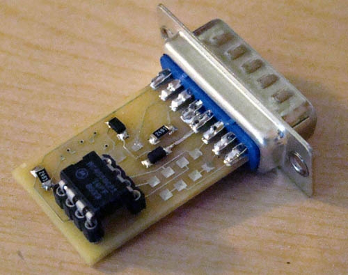

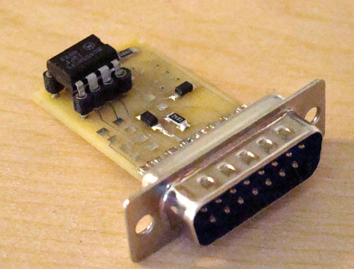

You got it backwards. What I proposed was converting
your card-edge male to a d-sub by soldering the wire-cups
of the connector to the tabs. Here is an example of a product
that uses solder-cup d-subs to bring the connections
off an ECB.
[img]cid:.0[/img]
[img]cid:.1[/img]
Like so.

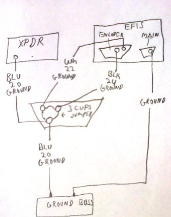

Grounding
I also needed to run grounds from the transponder to the encoder on the EFIS and to the common ground buss. My solder cups aren't big enough to put more than one wire in. Instead of splicing the wires together, I recalled that Bob had jumped a bunch of dsub solder cups together by placing a section of wire between them and soldering it all together. I did that for 3 of the cups and connected ground wires from the transponder and encoder to this. I wanted a 20 awg ground from the encoder, but only had one spare 24 awg wire left over in the cable. I used a 22 awg along with this 24 awg wire for this. Diagram below.
 Filesize:  38.23 KB
 Viewed:  8241 Time(s)
