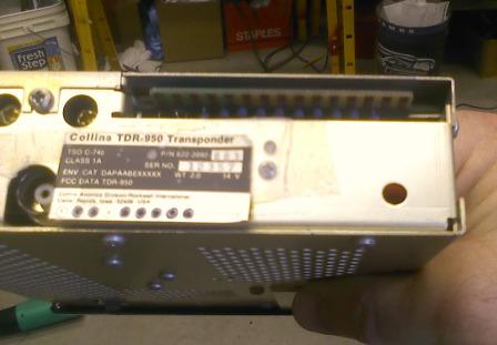

Hi!
I think I'd like to solder wires to the back of my transponder board. Using the supplied edge card connector housing, I couldn't get the contacts to lock into place. Instead, they'd move around inside the housing. I figure I could cut these contacts off the ends and solder the 24 awg wires directly to the board.
I was able to solder a D-Sub15 onto the end that connects to the encoder (EFIS), so I plan to make a male-female connection of the d-subs in case I need to service the unit.
I've never soldered to a board, but imagine it's easier than the cramped solder cups I've already done. Main questions are heat and cleaning. I've got a 30W iron. How long can I leave a tinned tip on the board before being concerned with overheating?
I also read a little about cleaning the board after soldering, cuz of the flux. I'm using Kester 44 resin core. Should I wipe the board with rubbing alcohol after I'm done?
Suggestions appreciated.
Dan

PostPosted: Wed May 18, 2011 6:47 am    Post subject: Re: Board Soldering: Overheating and Cleaning? Reply with quote
The ISA and PCI connectors both had nice edge contacts
Yes, I think mine prolly does have some of those.
I tried freeing up the case from the board to give me a little more room, but stopped after about 20 screws when I felt that something might come loose that I couldn't easily reattach. There's ~1/4" gap below the card edge and metal back of the case. My soldering iron can reach it at a 45 degree angle, so I think that'll work.

Thanks, Bob, except I've got 15 tabs on the bottom 3 or 4 on the top. At this point, since I've got all the pieces to do the direct soldering and D-Sub 15 connections, I'm leaning in that direction. Soldering the male pins to the board wouldn't be very easy either, since the metal shell would protect the pins from the solder tip. But if there was room to maneuver, it would make for a slick connection, all right.
