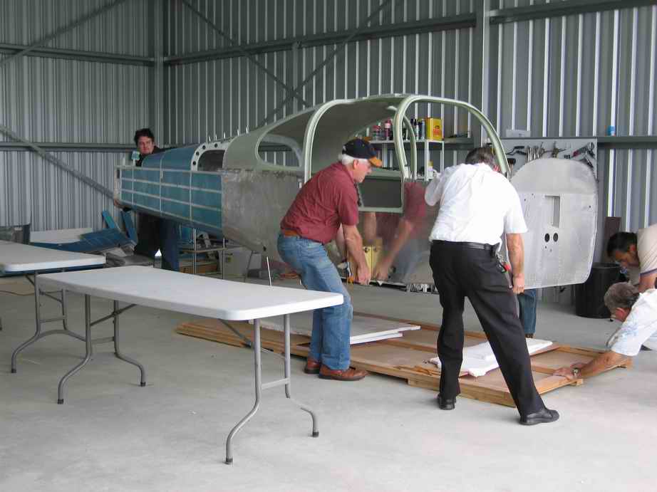

I used a carton of beer ... to entice a few friends to help lift the fuse onto tables!

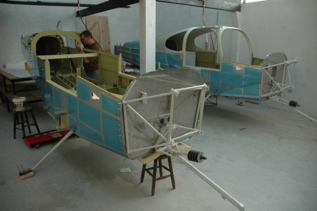

This sounds like a good way to join the half. I plan on doing it. As to the question about putting the legs on I have found this hydraulic cart from harbor freight a great tool in working on the fuselage. It cost a couple hundred bucks but it has been very useful around the shop for other things, like moving a heavy metal bending tool. It is easy to move around and adjust to the right height and is narrow enough and makes a pretty stable platform. I can see it would be better with the gear legs on when crawling around in it to make it stable. Check it out on my site it is about 16 pictures down the page at http://www.etigerrr.com/Fuselage/section_28_fwd_fuse_ribsP28_16.htm
