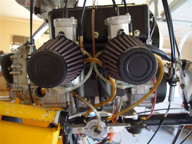

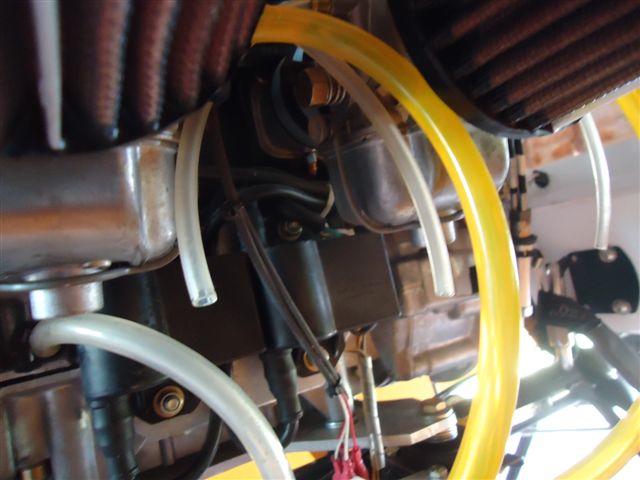

PostPosted: Sun Jul 17, 2011 9:57 am    Post subject: Re: Need advice 503 Rotax/ Bing dual carbs/ oil injected Reply with quote
Thanks for the link !
Part of my problem was this: ......... See Photos below
When I purchased my plane those lines are vent lines to keep barometric pressure on top of the fuel in the bowls. If the holes are not in that line, low pressure will build up off idle and not run.
Mine were looped, so I cut them both on each carb. Rotax now runs smooth.
