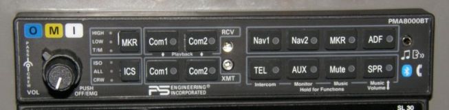

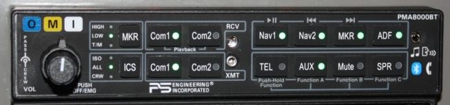

But while I was on my Baja trip, I became aware of an upgrade to my new
PMA8000BT, and I thought I should pass the information on. If you
compare the 2 photos below, you'll see some of the visual changes that
they made.
Original PMA8000BT Button Labels
(See photo below)
New PMA8000BT Button Labels
(See photo below)
Notice how the top picture has "PUSH-HOLD FUNCTION" under the "TEL"
button, and then the Function A, B, & C. along that bottom row of
buttons on the Right. Well, while I found it workable, it was kind of
discombobulating to try to hold the TEL button and press buttons that
were right next to it, to get it to change functions. The changes were
for things like Music distribution, Intercom Function (which changes
wether the passengers hear the radio conversations or not), and
monitoring functions that would give monitoring priority for Com1 over
Com2 or not. They're functions that you may or may not change fairly
often...in my case, I did actually change them quite often as there are
times the passengers want to hear the radios and times that they don't.
Well, in the new software release, they got rid of that 2-finger
operation, and instead went to a single-finger method, where you push a
tap (or just a short push) to activate the primary function, but if you
push and hold, you change the secondary function that's labeled below
the button. I'm not sure how to best describe it, but if I push and hold
the MUTE button an extra half-second or so, it changes the music
distribution settings. It makes it much easier to change function
without holding your hands in a way that lets you do the
2-buttons-at-once maneuver.
>> new PMA8000BT, and I thought I should pass the information on. If you
>> they made.
>> (See photo below)
>> (See photo below)
>> are times the passengers want to hear the radios and times that they
>> don't.
>> a tap (or just a short push) to activate the primary function, but if
>> you push and hold, you change the secondary function that's labeled
>> below the button. I'm not sure how to best describe it, but if I push
>> and hold the MUTE button an extra half-second or so, it changes the
>> music distribution settings. It makes it much easier to change
>> function without holding your hands in a way that lets you do the
>> I was told that there wasn't too much along the lines of new features
>> for the software, and that my old one would still basically do most
>> everything the new would, but it would be easier to use. I did see
>> though that you can now adjust the volume of your bluetooth music via
>> the control panel, so if your phone or device is not very loud, or too
>> loud, you can tweak it slightly to make it better. I still control the
>> volume of music directly from the device like my iPhone, but now I can
>> tweak the overall range that's available
>> Another feature that is new is that upon powerup, the new software
>> will speak out the current settings of the intercom, monitor, and
>> music modes, so when I first power on, it will say things like
>> "Standard Intercom Function" and so on, telling me how it's
>> configured. It's not an annoyance as it only takes a couple seconds
>> and it's all done, but it does give you a reminder of how it's
>> configured so that if you just picked up passengers and don't want
>> them to hear radios, you will know how it's set.
>> All in all I think it was a great little upgrade. I do kind of miss
>> the labels above the top row of buttons for Play/Pause, FF, and REV,
>> for the music....personally I think those labels should have stayed,
>> but....A) I didn't use them much, and B) once you use them a few times
>> you kind of memorize where they are, so I can't complain too much. The
>> trade-off is that the intercom functions a bit easier, so it's worth it.
