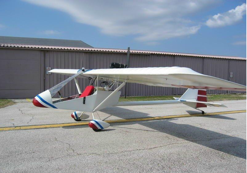

My 1st ultralight,original Firestar.447 Rotax,b box with a Warp Drive ground adjustable prop.

Nice Job Ron!!
She looks beautiful.

Awesome looking little Kolb....Enjoy it !

You got your self a Fun little airplane to fly there enjoy it Surprised)

nice looking plane...thanks for posting...jim swan

Looks like a great plane. I picked up one in mid March. Looking forward to flying it as well.

Beautiful plane you have there. Regarding flight advice, here's my recommendations. Do a lot of taxiing. Not only to learn how to taxi, but to become familiar with your proximity to the ground.  This will help you judge your landing, because you have to get the Kolb really close to the ground before the flare. Also, as most experienced Kolb pilots will tell you, approach your landings with power, about 3500 RPM, to prevent stalling during the flair. You must keep it flying until you are really close to the ground. No 10 or 15 foot flairs in a Kolb. Because of the light weight and drag of the Kolbs, they lose momentum quickly and if you are too high when it stalls, you will drop in hard and bend your landing gear legs, or worse. Homer Kolb wrote in the original FireStar builders manual a section on how to fly it. He said to do crow hops. I know a lot of pilots on this list disagree, but I did it his way and it worked good for me. Hold the stick all the way back to prevent the thrust from pushing the Kolb over onto it's nose. Slowly add throttle and at about 3000+ RPM it will lift off in ground effect, then you immediately reduce the throttle some, let the stick go forward slightly and it will settle back down onto the ground. Just don't let it get too high. Although I had 42 hours of flight time before flying my Kolb, I hadn't flown for more than 27 years. I got an hour of time in an Aeronca Champ before trying the Kolb. Your low time means you need to be very cautious. Good luck.

Ron, Looks like a nice little plane, I hope you have many happy hours flying her.Not to be the turd in the punch bowl, but your Firestar most likely is not a legal ultralight, they're too heavy.
It probably won't ever cause you a problem, but just in case, don't have the number one dead giveaway, make sure you don't have a fuel tank bigger than 5 gallons. That's the legal limit and except for a second seat, it's the one thing that someone can walk up and see that your aircraft doesn't qualify.
