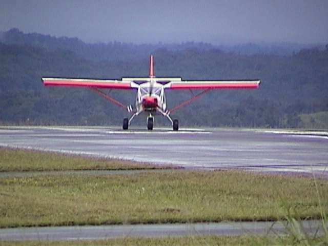

Attached is a front view of my extensively-modified 701 in Ecuador, a very happy decade a-building with professional help and successfully flight-tested:
1. Rakish 0.16" sheet aluminum cowling for Rotax 912 in two piano-hinged sections, secures with two Camlocks each side, removes quickly; custom fiberglass nose cone, big spinner; both radiators out in the propwash;
2. Raised skylight for tall pilots, curved windshield;
3. Doors bowed out for elbow room, held open by gas struts, lots of extra glass;
4. Custom IFR panel -I like "steam gages"...;
5. Electric flaps;
6. Padded seats and seat backs, military-style belts;
7. Large access panel to battery on fuselage side, "bomb bay" bottom access.
Pics, details on request -please specify.

Looks Cool.
How about some more pictures.
Rick
