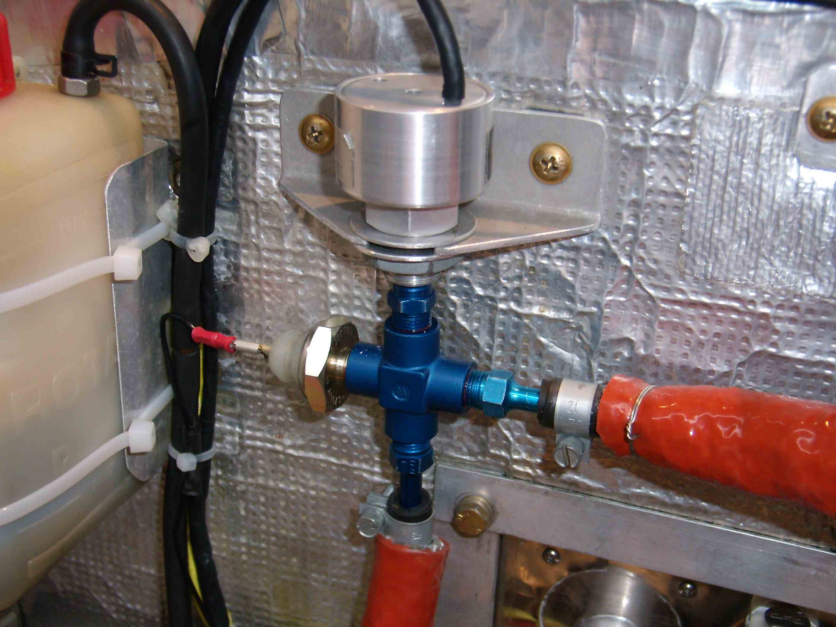

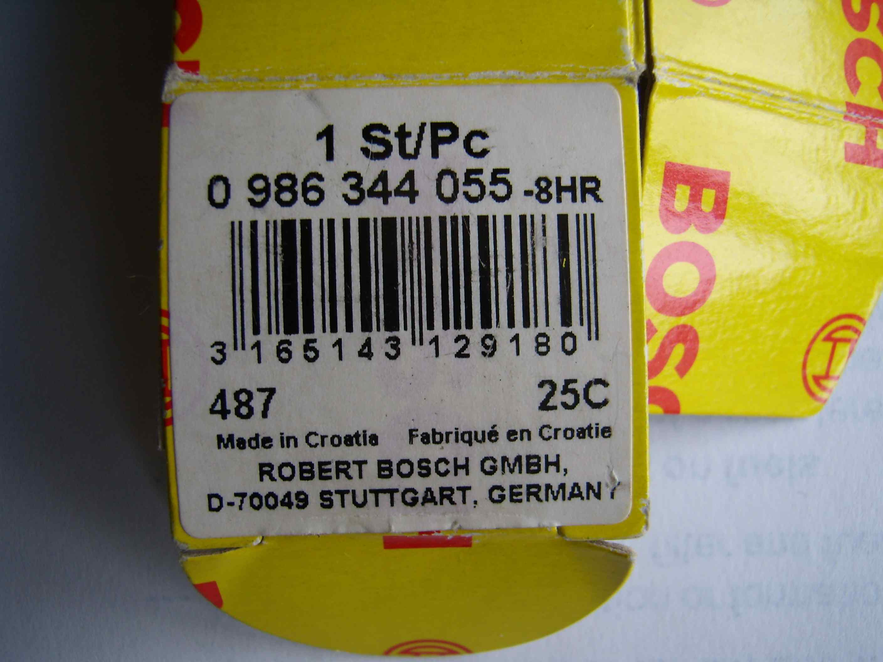

I am also using the Katana fuel pressure switch. Attached pic shows the Bosch P/N. I have not found any other solution than buying it from Diamond and it cost me around 100 Euros, as far as I remember. Same looking Bosch pressure switches sell for less than 10 Euros but they are rated for oil pressure, that is ten times what we need.
The other picture shows the intallation on the firewall of my aircraft. The switch is on the left side of the picture. On the top is the UMA fuel pressure sensor. The right fuel line comes from the tee on the carb fuel line. The bottom fuel line goes back to the tank and includes the restrictor.
