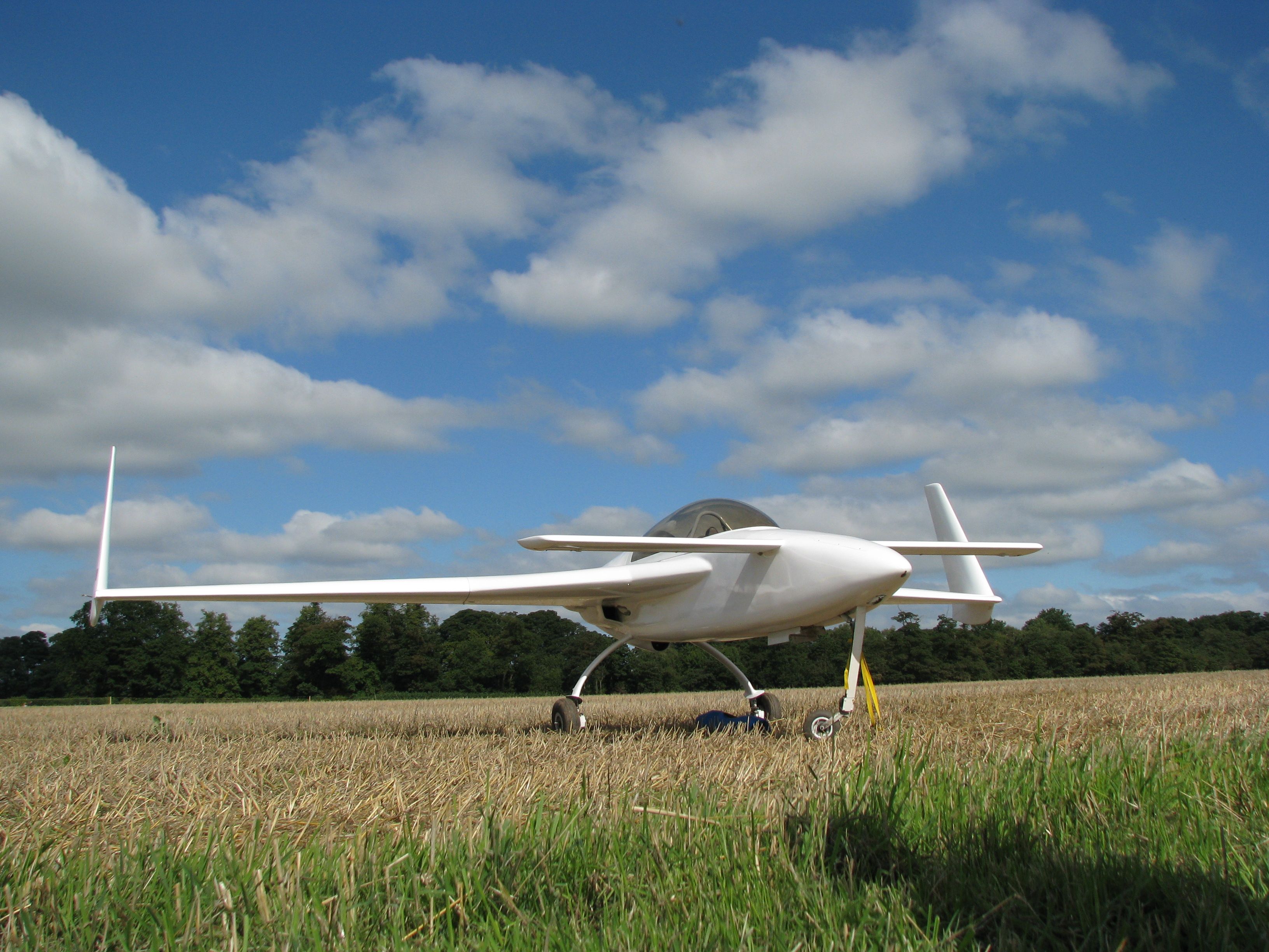

Hi Brian
maybe I should do it on my Lycoming. Plenty of heat under that cowling. The exhaust extraction works well though.
Graham

PostPosted: Wed May 11, 2011 7:34 am    Post subject: SV: Carb, fuel and oil tube heat shielding Reply with quote
Nice pic, Graham.
Is it flying again?
Brian

grahamsingleton(at)btinte
PostPosted: Wed May 11, 2011 7:48 am    Post subject: SV: Carb, fuel and oil tube heat shielding Reply with quote
Not yet, I just sent off the application for engine mod. Then final inspection and apply for test flying.
Graham

PostPosted: Wed May 11, 2011 8:18 am    Post subject: SV: Carb, fuel and oil tube heat shielding Reply with quote
Graham,
Very pretty EZ.
Bob Borger
