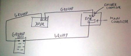

Grounding
The pinout table says number 1 goes to ground and MGL says also to ground the xpdr to the encoder connection of the EFIS. The EFIS is also grounded separately from its main connector to the ground bus. Is this the way to do it? I'm concerned about ground loops. I've attached a schematic of what I think they are suggesting, showing just the ground wires.

The grounding schematic I posted earlier is correct, except that now that I will not be using pin #15 as a ground, I'll jumper the grounds from the ground bus and encoder to the single ground pin of the transponder, pin #1.
