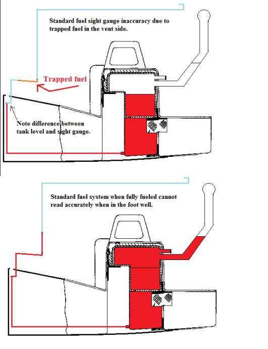

<?xml:namespace prefix="v" /><?xml:namespace prefix="o" /><![endif]--> [img]cid:00a101cc0dfa$02C34B75(at)adminPC[/img][img]cid:00a201cc0dfa$02C34B75(at)adminPC[/img] Photo E-mail [url=http://photos.msn.com/Viewing/Album.aspx?PST=8nK2AN1B!1LEiKSdooxx9v4CFFiF2tnPzfqiCRx5lZJb1PK8cJ43U178Cj9K5v0dBOyRUP8ehqN5EQNFDiaRvA%24%24]Play slideshow[/url] | [url=http://photos.msn.com/viewing/Photos.aspx?pi_Type=SlideshowTask&Task=Download&stppData=&pi_ImagesOnly=1&Folder=nBuRgwTGIGjZPMtNhxCyPhYLUBR*bYP2uzFIOVTpF0g%24&User=23IQaj7Z2BRqNO1wUECSpX*P0Ju9hSGI&pi_NoLogin=1]Download images [/url] Ivor and all,
The original Classic tank in N139AB held 2.5 gallons in each saddle. The tank itself when filled up to the upper level of the boss (fuel inlet with that horrible old hose) which means a slight amount of fuel in the filler tube, held 18 gallons.
The XS 2000-2004 with the horrible depression in the top of the tank also held 18 gallons.
Keep in mind, the tail dragger will hold less because of the trapped air in the front of the tank, unless there is some shacking and tail lifting involved.
The last set of tanks made with the diagonal reinforcement molded in the back (thanks to Roger and John), have a very flat top and is wider by some 1/2 inch or so. On replacing the original tank in N12AY (which cracked) with this new tank, my capacities are the same on the reserve side and main at 2.5 gallons each. The total capacity of the tank in the tri gear N12AY is 20 US gallons. This has been checked and verified three times and frankly welcomed on cross country. The fuel level at 20 gallons in the filler neck is 1/2 way up the tube. Gary Leinberger's is the same way after his tank swap.
The CFC modified fuel sight gauge (see " A sight gauge that really works" at www.customflightcreations.com) works both in flight or on the ground. Keep in mind, in the standard fuel system, the vents on the top of the aircraft cause some low pressure problems pulling the fuel in the sight gauge off a bit in flight, as does acceleration, deck angle etc. making it less than repeatable and accurate. Also, most inaccuracies in any sight gauge come from fuel trapped in the vent side of the site gauge (see crude drawing below). The indicated reading on the site gauge is greatly affected by this trapped fuel either with the CFC modified sight gauge or the standard. Being human, we run the sight gauge line with some areas that run down hill a bit and cause fuel to be trapped as it is tough to get fuel across the panel bottom, down the side, then up the windscreen and down the top to the vent. If this installation is done perfectly so it traps no fuel, the standard sight gauge is reasonably accurate. Retrofitting the CFC line is no picnic either if the tank buts up against the top of the tank compartment or a lot of foam is used on the top of the tank...
N12AY is equipped with JPI fuel totalizer, a sight gauge and a capacitance fuel probe. Only the capacitance fuel probe has been a problem when changing from ethanol enhanced fuel, to and from AV gas. Ah to have the float gauge. One piece of equipment I carry in my aircraft is a short piece of 1/4 inch hose to blow air down into the sight gauge vent in the filler neck to remove any trapped fuel if I find it inaccurate after spirited flying, turbulence or overfilling.
