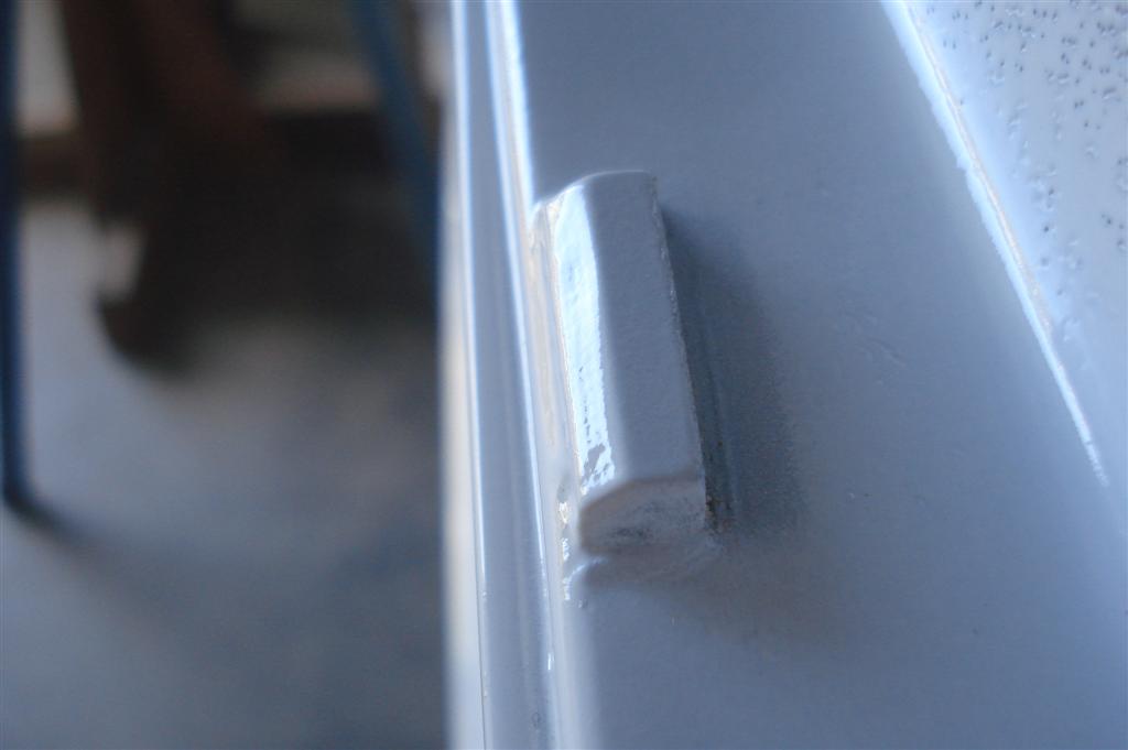

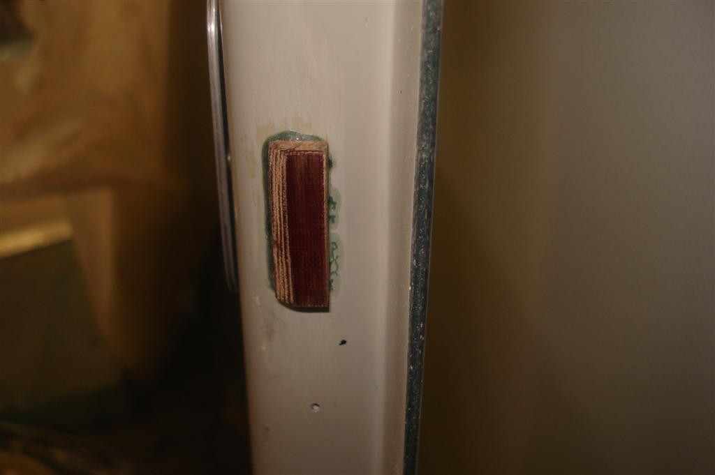

Rick,
I haven't had any problems with my doors but I made the attached auxiliary
latchs for the doors because it seemed a good idea at the time.
They are made of Tufnol and are 25mm long. If Neville Eyre is lurking . .
they are 1" long.
Note that the door part latches over the sill part on the inside face.
Hope this helps
Kingsley

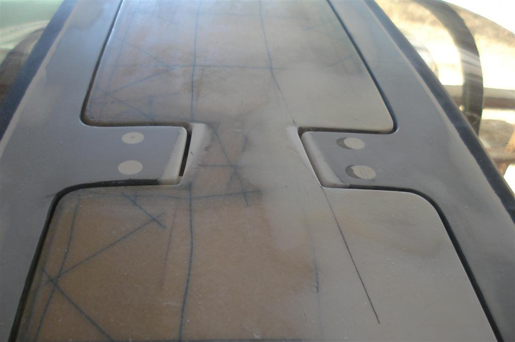

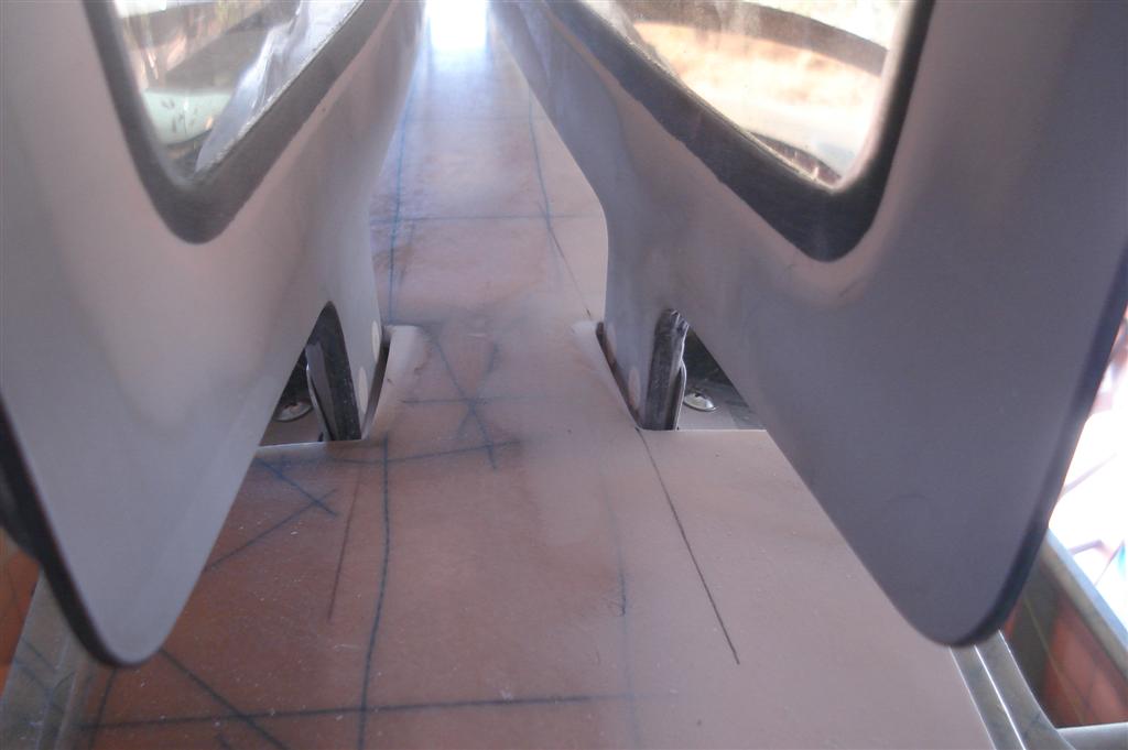

PostPosted: Thu May 05, 2011 9:43 pm    Post subject: Door wedges??? Reply with quote
Now, can someone tell me why the door tangs don't finish square with the
hinge line??
Because this was left as an exercise for the builder !! IOW, the factory
stuffed up.
They can't be square with the hinge line Tony but the geometery can be
corrected. See attached.
Kingsley

Kingsley...for the life of me, I can't get my mind around what you've done and how it keeps the door from bulging out...Could you help orient me to your photos #1 and #2?
Fred
grahamsingleton(at)btinte
PostPosted: Fri May 06, 2011 9:15 am    Post subject: Door wedges??? Reply with quote
Fred
the door flexes enough to let the wedges slide over each other and latch. When the shoot bolts are engaged the door can't flex so
it won't bulge out and suck your sleeve into the gap. I was flying one hot day and had the vents open and couldn't work out who was tugging at my sleeve at 4000 ft.!
Graham
Sorry if I confused you Fred . . . . I hope the attached will be easier to follow.
Bear in mind my honourable friend, I don't know if I really needed these devices but I did them anyway if for no other reason than to satisfy my determination to take 20 yrs to build the aircraft !!
Cheers
Kingsley

fklein(at)orcasonline.com
PostPosted: Sun May 08, 2011 1:04 pm    Post subject: Door wedges??? Reply with quote
Kingsley,
Your sketch saved (at least) 1000 words...thank you.
I was having trouble orienting my mind to your photos, and I'd fixed
in my mind the notion that the chamfers were relevant.
