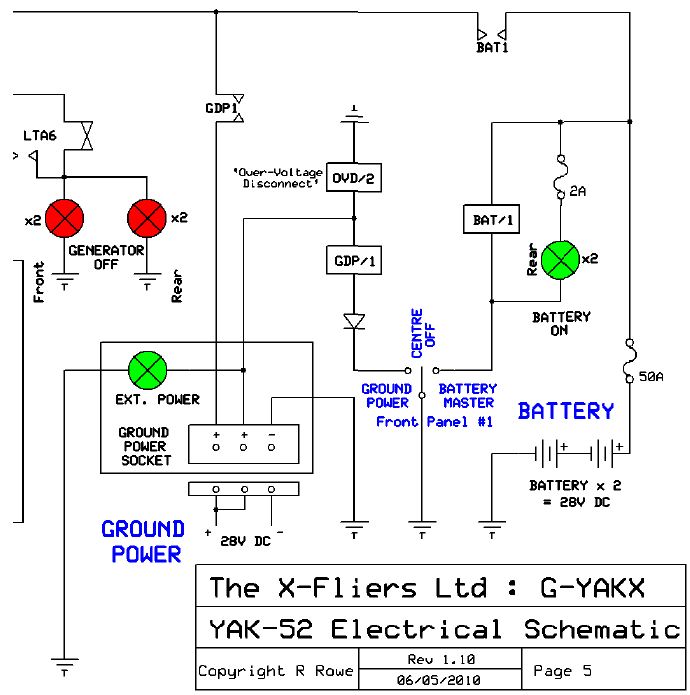

Nigel,
All good advice you've been given ... have some further thoughts for your consideration which may be carried out from the relative comfort of the rear cockpit without having to get inside relay boxes etc.
With ref to the attached simple schematic of the battery power feed.
1 - With the Master Switch set to 'Battery' check to see if the REAR cockpit 'Battery On' annunciator light is illuminated.
If it is lit then most likely the DC Relay Box relay coil #6 ('BAT/1' - my nomenclature) has failed open / bad connections / mechanically failed, which can be replaced temporarily with #7 ('GDP/1' - my nomenclature) ... as already advised. The Russian relay type is 'TKD-501DOD' (anglicised).
Note - there is a 2A annunciator light fuse that could also stop this lighting, but very unlikely this will have blown
2 - If the 'Battery On' light is not lit, then turn the Master Switch OFF & try the following;
a/ in the REAR cockpit gently remove the green tinted plastic cover off the 'Battery On' annunciator light & remove the two bulbs inside
b/ obtain an electrical multimeter and set a RESISTANCE range of 0-2000 ohms (or similar), use this to measure the resistance across the bulb socket contacts (either socket will do as they're wired in parallel)
c/ no reading (open circuit) - double check you've made good connections. Or previously mentioned 2A fuse has blown or relay #6 coil connections are bad in relay box
d/ meter reads close to zero ohms - the relay coil #6 has failed short and probably taken out the 50A fuse with it. Test 50A fuse continuity first. Then remove relay #6, retest to make sure the short has been removed, replace with relay #7, retest again to make sure the short has been removed and only then replace the 50A fuse as needed
e/ meter reads somewhere between 50 to 400 ohms - suggests the relay coil #6 is OK (it may have mechanically failed though), therefore either the Master Switch has failed and is not providing an earth or something else such as a wiring fault. If meter reading much higher than 400 ohms then possibly relay coil #6 connections are poor.
f/ Master Switch failure - with the Master Switch still OFF, set your multimeter to a DC VOLTS range of 200V (or similar). Place the black lead on a bare metal chassis earth point and the red lead on each of the bulb socket contacts in turn. If you get a voltage reading on both contacts of c.24V then the Master Switch, or its intermediate wiring, is failing to complete the circuit by not providing an earth (it also proves your 50A fuse is intact)
g/ Wiring fault - you need to get a professional avionics guy in to help as this is non trivial to identify
WARNING - this is theory, I've not done this myself so YMMV ... however little harm can be done either. It's not intended to cover every eventuality but should at least help localise the issue.
As always though if in doubt ... don't!
Hope this helps.
Brgds, Rob Rowe
