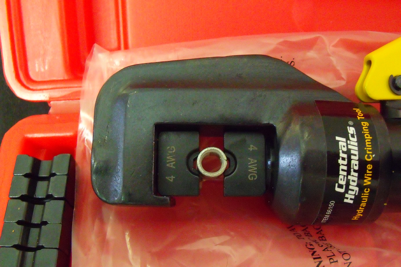

HFT sent me a 20% off coupon with no limit on sale items so I treated myself to one of their Hydraulic Crimping Tools (part no 66150) for $39.95. When I got it home I was surprised at how small the crimping dies were. I'm not sure they're sized for the wire, much less the connector.  The picture shows the AWG 4 dies with an Amp # 4 connector.
Does anyone have experience using this tool? I'd like to hear from you before I make up my mind whether to keep the tool or not.

Go ahead and put a terminal onto a 4AWG wire
and see what it looks like. I might have you send
me the installed terminal and I'll slice it open
for microscopic examination. How many die sets
come with the tool?
Did you check out the reviews on the website?
http://www.harborfreight.com/hydraulic-wire-crimping-tool-66150.html
One reviewer suggested that the dies remind him more
of tools for installing wire-rope fittings than for
copper wire. Other folks have reported good results
but universal disappointment on the squash-ears that
result from having too much copper in the mash-up.
Put some terminals on an enlighten us with your
own perceptions.

12, 10, 8, 7, 6, 4, 2, 0, 00
Rick
Yeah, went to the website and looked it up.
That's a pretty good range. Too bad they
didn't make those hex shaped holes tailored
more closely to the real-world of terminals.
But then, we have no knowledge of what the
designers were handed for design goals . . .
nor the market demands that drove the decision
to fabricate the tool.
I'll be interested in seeing what your test
crimps look like.
