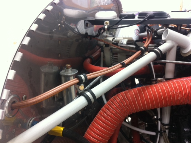

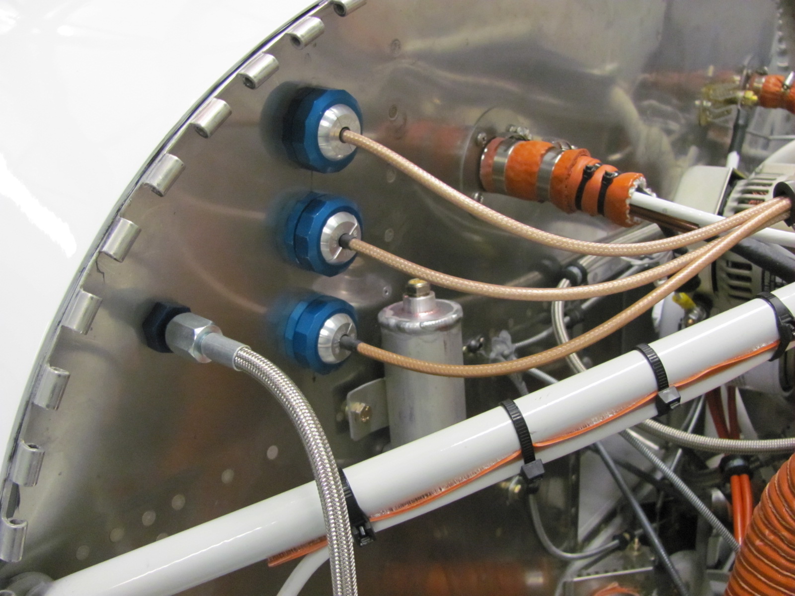

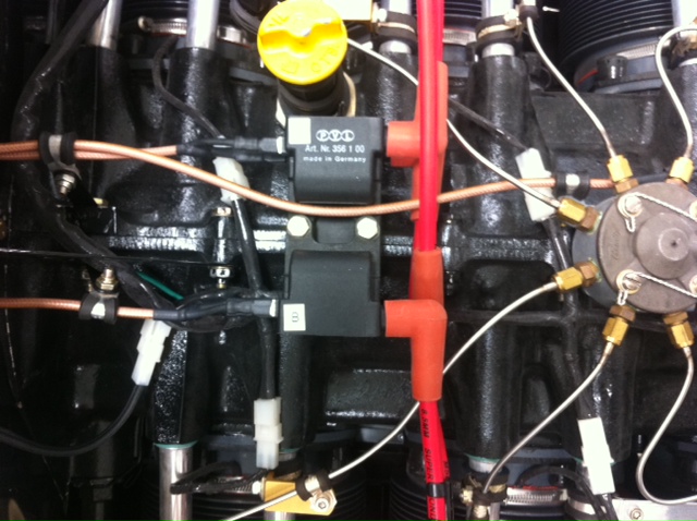

Here is what I did.
-Mike Kraus

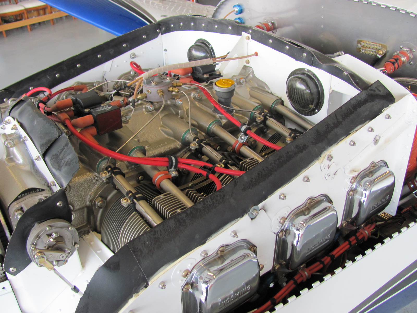

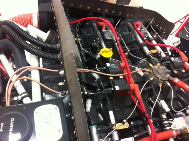

Michael here is what I did same as Tim on the fire wall and then into the
Baffling I used silicone grommets.
See Pictures

PostPosted: Mon May 02, 2011 4:21 pm    Post subject: Ignition wire routing on IO-540 with lightspeed ignition Reply with quote
Mr. Combs,
Where did you get the great looking round covers for the upper engine mounts. I've used a lot of RTV and still mine engine mounts are not sealed very well.
G. Hank Nolin, P.E.
832-640-6284
Alias- RV10 Soon.
