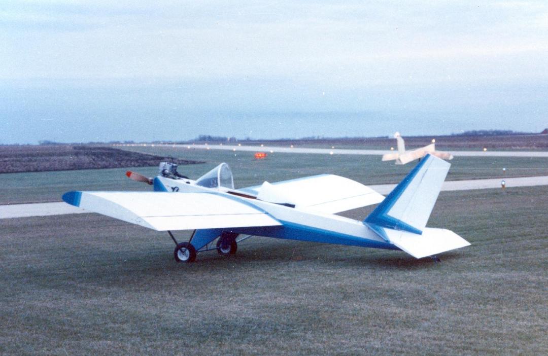

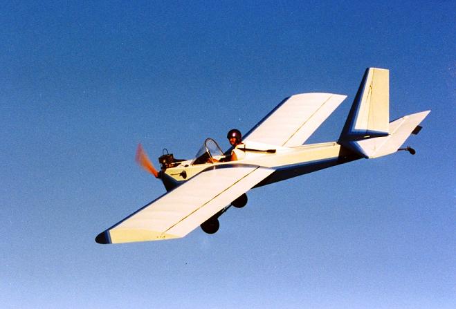

Larry Vetter
Joined: 03 Dec 2009
Posts: 35
Location: Manson,Iowa
PostPosted: Wed Nov 09, 2011 12:04 pm    Post subject: Re: What ultralight? Reply with quote
The TEAM/ISON/JDT line of light planes includes a couple ultralight versions and a very large group of supporters( East Tennessee Lonesome Buzzards)
Can be built from plans only or mini kits or full kit. also a few around for sale already built.
Nice airplane with good flying characteristics, and a good safety record.
Larry
