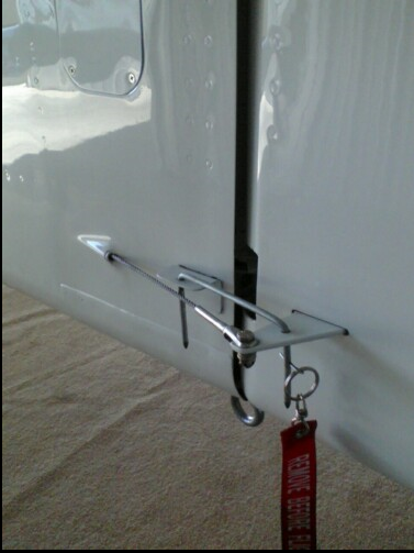

PostPosted: Fri Apr 29, 2011 7:50 am    Post subject: Rudder gust lock Reply with quote
I did something similar to Robin, but with the ' drop down' . One word of caution, when I initially installed the gust lock, I installed it only on one side, and I did not put 'retainer pins/clips' to hold in place, During a trip, we experienced some extremely strong winds one evening (40-50 mph gusts) and with the drop down retainer 'crept' upward bit by bit until it allowed some movement in the rudder, and then it progressively crept up until the movement was large enough to pull the attachment bracket off the plane.
The solution for me, was to replicate the gust lock on 'Both' sides of the rudder, and to add retaining clips to the drop in brackets that do not allow for any 'creep'. The retainers are just some 3/16" ss rod bent in a wide "U" and drilled for some retaining clips which are wired together ( so as not to loose them) with a Remove before Flight flag. It's rock solid now and haven't had any subsequent issues.
Attached is an early picture before I added the other side and snugged up the retaining pins.
Deems
[img]cid:part1.02000008.00030309(at)cox.net[/img]

PostPosted: Sat Apr 30, 2011 6:35 pm    Post subject: Rudder gust lock Reply with quote
Thanks guys for the response. Robin's method is just the ticket, however I'm not sure how much of the tailcone structure I need to pick up, so I don't damage anything in winds like we had all day long yesterday, here in Vegas. If I was building the tailcone now, and things were accessible, I would put in some serious reinforcement to carry the load, but now as an afterthought, I think an external bracket could be made that goes forward and bolts to the little stiffener that attaches to the aft bulkhead. The bracket could then go down to line up with the horn, and catch a couple of inches of the aft bulkhead along the way. Or maybe just one that runs up and down the bulkhead a few inches is strong enough? A bracket on both sides with retaining clips is also a good idea.
Chris Hukill
