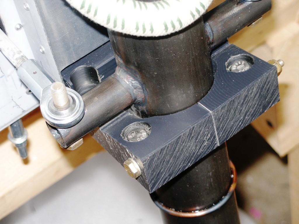

The fastening of the bearing block is another thing. I didn't feel secure about threading that plastic for the bolts. I drilled the bolt holes all the way through and used a Forsner bit to make a recess for the bolt heads so they wouldn't interfere with the steering rods. See photo. I used all-metal self-locking nuts on the bottom.

If you want to save 135.00 just do what I do on all my 601 V block's I use a flat drill bit a couple sizes smaller than the bolt heats and drill the top of the v block deep enough for the head to clear the gear centering tube then just put a nylock on the bottom side of the v block and to me it is much stronger. The bolt doesn't turn as you tighten the nut because it was drilled undersized and the nylon holds it tight.
I will try and find a pic..... Keep in mind you really have to clamp down your work as it will try and grab the nylon as you drill it. use one piece to make the other piece level for drilling then reverse to drill the other.
