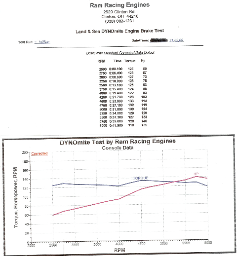

fklein(at)orcasonline.com
PostPosted: Thu Apr 21, 2011 1:32 pm    Post subject: Honda? Reply with quote
Graham,
In my case, my RAM Sube comes w/ an Autoflight, NZ helical gear PSRU...I opted for a 1.9 ratio since my engine has separate air intakes for each cyl. and puts out 140 hp; see:
http://www.ramengines.com/id5.html
for hp/torque "curves", see:
[img]cid:C8297A30-FD9C-4039-9E29-83E8DAEBD9EB[/img]

 Filesize:  138.75 KB
 Viewed:  10713 Time(s)

I've always admired the Sube engine, designed originally as an aircraft engine alternative I believe around or after WW2? Pity Rotax didn't copy it. Hope your gearbox is reliable.
Graham
From: Fred Klein <fklein(at)orcasonline.com>
Sent: Thursday, 21 April, 2011 22:26:25
Subject: Re: Honda?
Graham,
On Apr 21, 2011, at 1:32 PM, GRAHAM SINGLETON wrote:
