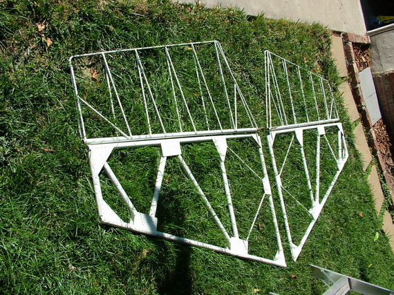

  I'm in the middle of fabricating balance rods for my MkIII's elevator(s).  I have the
"4 sided" horizontal stabilizers like some Xtras have, with the outer dimension close
to 11" or so (see photo).
  The balance rods consist of 3/4" chromoly tubing, with a 3" welded "T" stub that inserts
into the elevator's main tube and will be riveted.  At the moment, the rods are about 12" long,
and run the full length alongside the hor. stabs.
  Here's the dilemma!!  Even when I slide in 7" long solid steel weight rods into the ends of the
the balance rod tubes, this still doesn't come close to "blanacing" the elevators.  In fact, it takes
quite a bit more solid steel rod, hung out on the end of the balance tubes to get it to 'act' level.
  While I'm monkeying around with various weights, in occurs to me (duh!) that if I want to
'balance' the elevators......I'm going to need close to the full weight of the elevators!!   I can't
say that I like this!!  In order to achieve a true and complete elevator balance, I will need to
add a fair amount of steel rod!   (photos on request)
  Here's my question;  For you guys that have the elevator balance rods, did you really add
so much weight that the elevator was truely balanced, or did you possibly just add 'some'
weight, that would act like a reasonably decent counter-balance?
  I know another way to solve my problem would be to lengthen the balance rods, say...from their
present 12" length (which doens't work at the moment, unless they were maybe filled with lead),
to extend out in front of the hor. stabs 6", to something like 18" overall.  I sure DO NOT like this
solution, since, IMO, it looks like the balance rods were a complete afterthought (which they were).
Still....I don't want them to look dopey!!
  What did you guys do to balance your elevator?  Nothing?  .....Some weight, but not a complete
balance?   Or did you just add enough rod length to keep the weight low?
  I'm kind of at a loss at the moment, any thoughts??????

Mike, Your elevators have a center of mass that is a certain distance from the hinge centerline. The two together create a moment and an arm. To balance them you must have an equivalent moment and arm on the other side of the hinge line. The problem with using a solid rod is that the balancing mass isn't concentrated enough, i.e too much of the mass ends up too close to the hinge line. This is the standard Kolb solution for the aileron counterbalances. I have them and they work great, BUT if I were to do it over again, I would use a hollow tube and either stuff the balance end with lead shot in epoxy, or solder a brass weight to the end of the tube. The idea is to concentrate the most mass on the shortest applicable moment arm to balance the control surface.
As to whether to do a partial or a complete balance, I'd go for the complete balance if only because it's the same amount of work. The problem with doing a partial balance is that you could inadvertently hit a hamonic of the flutter frequency that could make the situation worse instead of better.
MHO with Beauford's caveat.

Mike W/Gang:
Why are you trying to balance your elevators?
Is there a flutter problem with Kolb elevators?

PostPosted: Sat Apr 23, 2011 6:24 pm    Post subject: When is balance balanced? Reply with quote
John,
I 'thought' there was...or could be. I was under the impression all control
surfaces needed to be balanced. I guess not...
I got an 'off-list' response from the list's most distinguished pilot, explaining
that many (all?) MkIII's don't have balanced elevators. OH!! I didn't know that.
I thought at least some of them were.
I do recall seeing somewhere where one Kolb builder used a balance rod
that was attached to the top of the rudder. Although I could not remember any
elevator balancing systems, I kinda thought a few guys did balance theirs

As a general safety principle, all control surfaces should be balanced. Go to your local airport and check the aircraft there, all having balanced controls (at least all the commercial ones). If you are in a quandary whether to balance, you actually know already what the safe insurance is. I seem to recall both aileron as well rudder flutter instances reported for the Mark III, in each case unbalanced. One pilot reported he could take out incipient rudder flutter by pressing hard on both rudder pedals. Which brings us, as far as I know of, to no reported instances of elevator flutter. Reason for that may be the connected weight/inertia of tight(er) cables to the control column all leading to a dampening of an incipient oscillation.
Herb Graff
