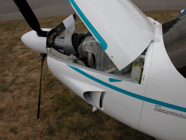

Alex Bowman's XS mono has a proper "bonnet"...I believe it is secured w/ 3 southco fasteners on each side...2 fwd & 1 at aft corner.
What I like about it is that in addition to being able to have a good look at everything, you don't have to worry about placing the top cowl on the tarmac or seeing it blown away in the wind when removed. Note the 2 streamlined surface pivots. I'm thinking about doing something similar but w/ concealed hinges...just thinking.
Fred
