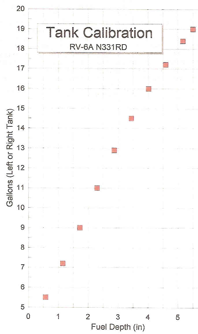

Hi Doug,
I did tank calibrations for my RV-6A in the normal attitude on the gear. It will be somewhat different for at tail dragger because of attitude. Anyway, I have attached my plot in two different forms: as a jpg file and as a pdf file. Hope it is of some use to you. It is a simple but tedious process. At the same time, I calibrated a "Fuel Hawk" dipstick which I used because of its convenience. It is a hollow plastic tube with arbitrary markings that you can calibrate for your aircraft. It works by dipping it in to touch the bottom of the tank holding your thumb over the top open end to keep the fuel in and reading fuel level on the calibration marks.
Rich Dudley

PostPosted: Mon Apr 11, 2011 10:44 am    Post subject: RV-6 fuel tank dip stick markings Reply with quote
Hi again, Doug,
Since my calibrations are sort of ancient history, I merely scanned old copies. I have since found the originals and extracted them. They are better copies. I've attached a pdf file of both the Fuel Hawk and the inches calibration curves.
Rich
