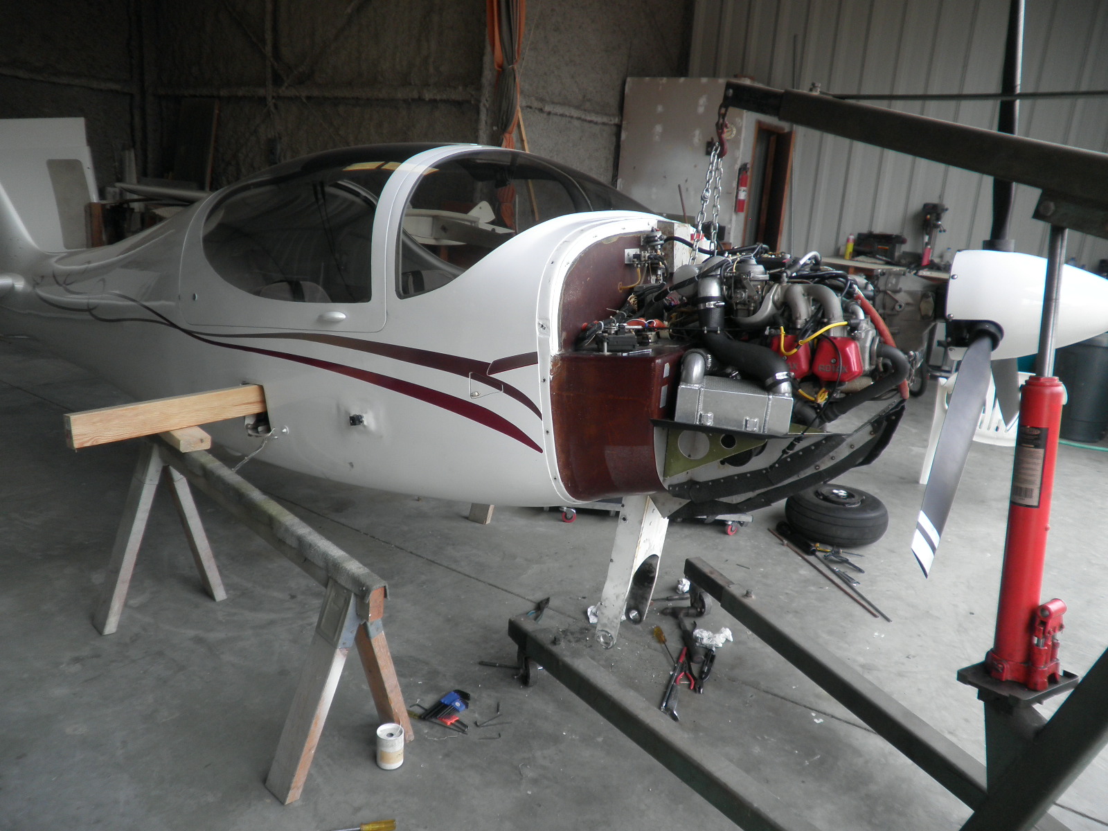

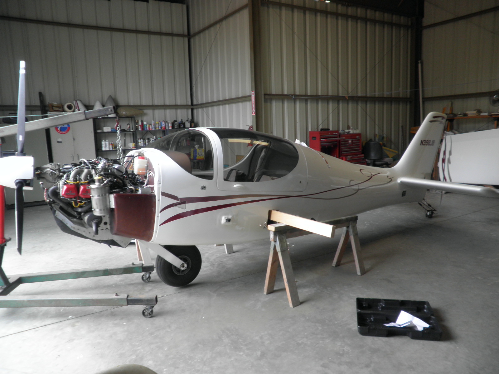

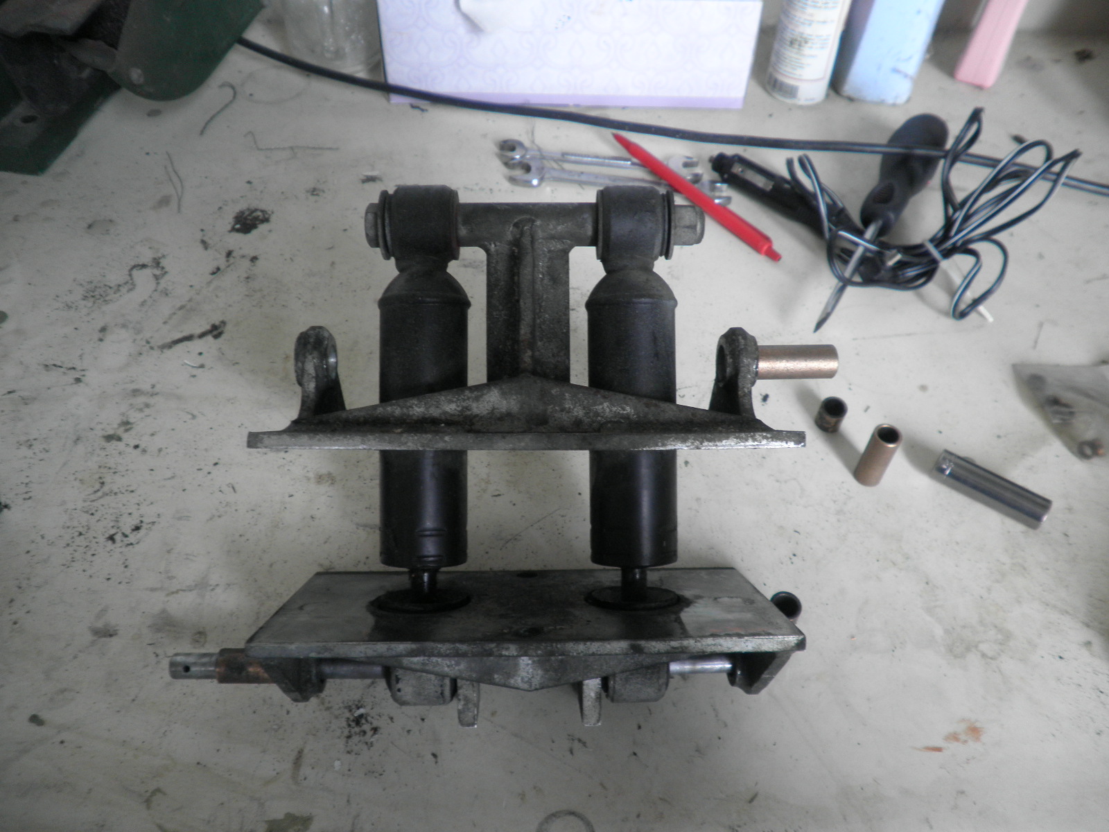

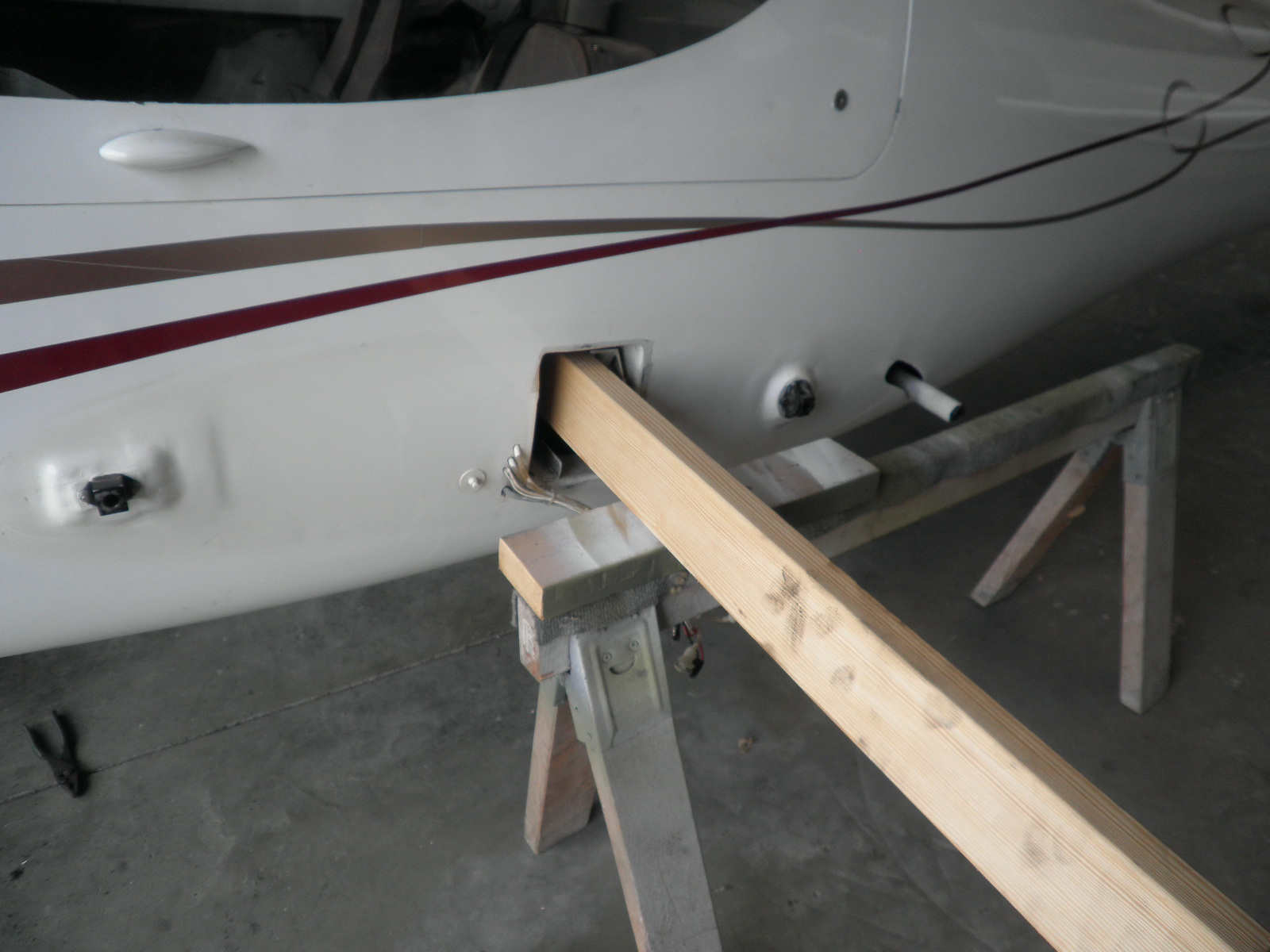

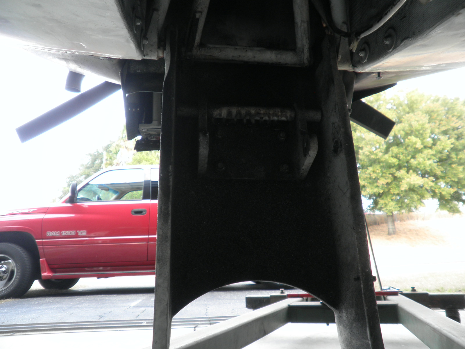

Martin, I just completed replacement of the rubber block, (black), bungee cord, and all of the bronze bushing in my plane..I used 3/8 inch bungee cord from aircraft spruce. I purchased 30 feet of cord. and used about 25 feet. You will need the extra length to have something to hold onto while you are wraping the cord around the frame.
You can tell if the bungee cord needs replacing by how hard it is to retract the gear... My original bungee cord had 7 wrap's around the frame.and so I replace with same number. My gear had reached the point that it took a hard push to get gear retracted.. I have 850. hours on the original setup.and 10 years time in service.. I also replaced all of the bronze bushings while I had the gear laying on the hanger floor.
The rebuild made a big difference in the gear retraction cycle, airframe set up higher, much easier to retract the gear. You will probably need to extend the outriggers. Buy new nylon replacement at Aircraft Spruce.. They have it in various diameters. You need the one and a quarter inch in diameter size..check yours to make certain...They sell it by the foot....
I have pictures of the whole operation, if you need to see.....

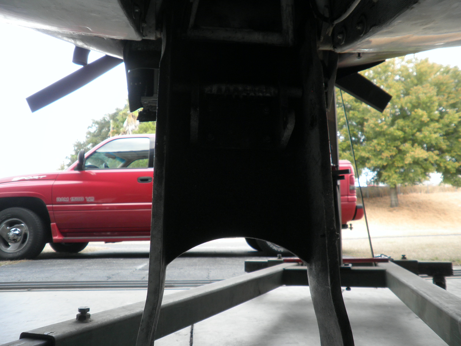

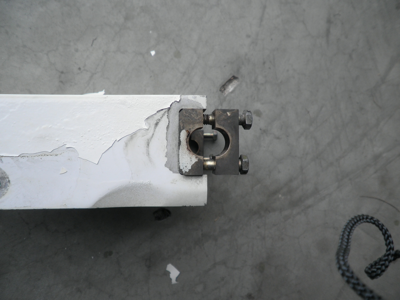

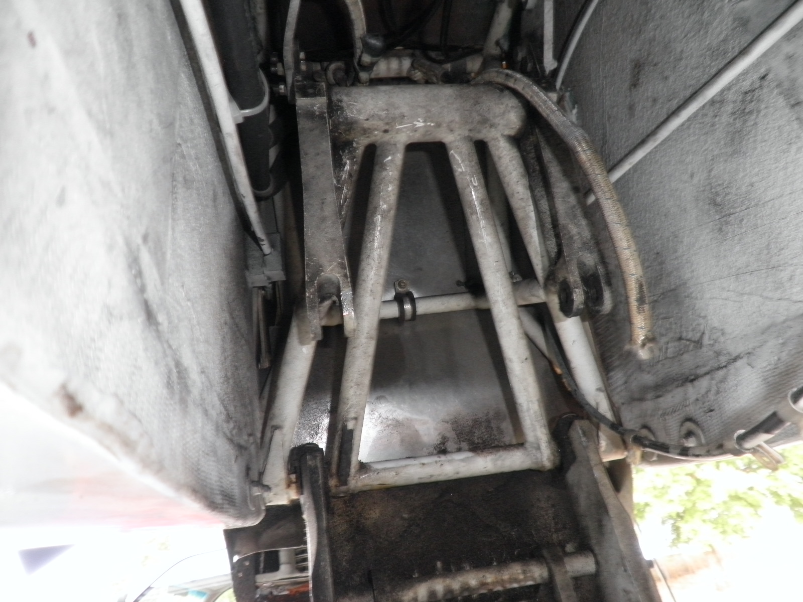

I got the rubber block several years ago...from someone who had decided to build the tri-gear. I would contact Bud Yearly, he has done several conversions from the mono-wheel to a tri-gear... He may have one from a conversion.......
The bushings are american size, not metric. They fit AN bolts..I found mine at a hardware store......They are just bronze bushing,
Attached are pics of the conversion...I can tell you for certain that it is a dirty, dirty, job.......make friends with your wife, before you give her the old dirty clothes.........
I will send the pictures in two different groups.
