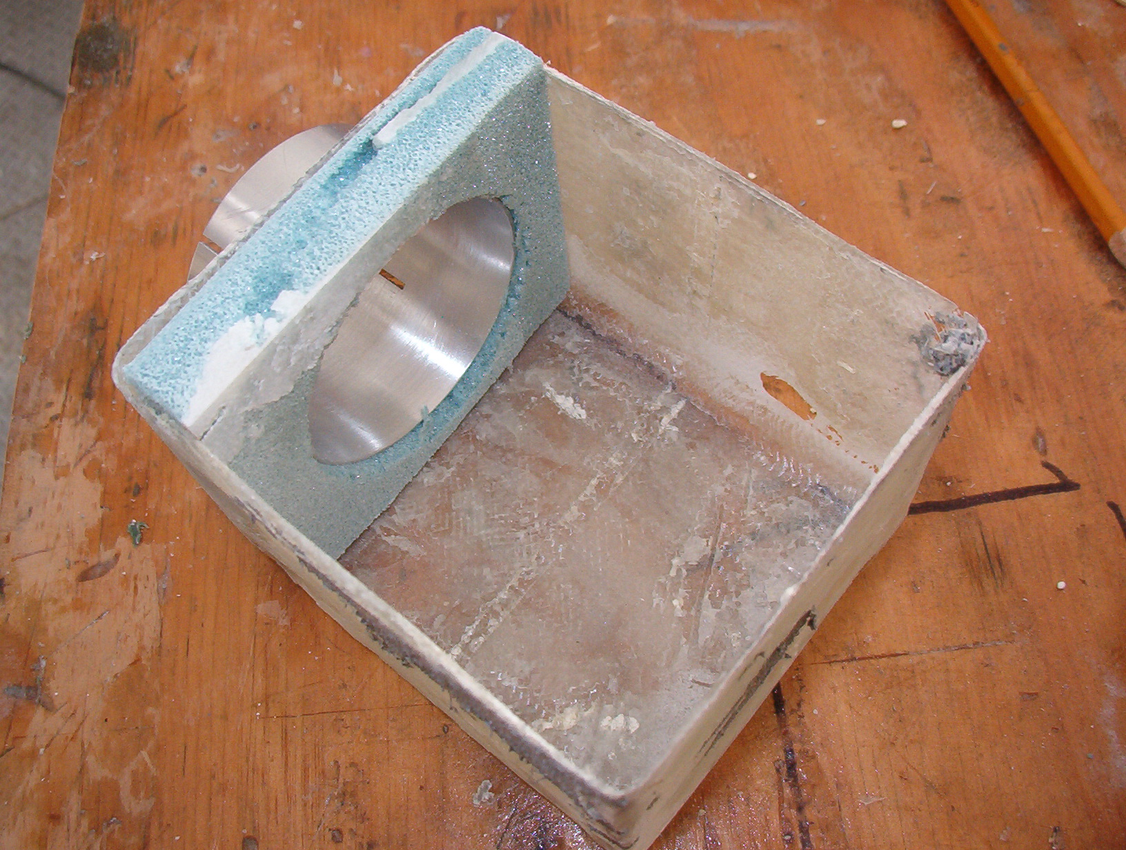

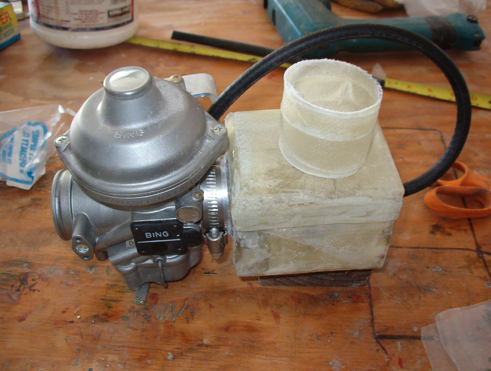

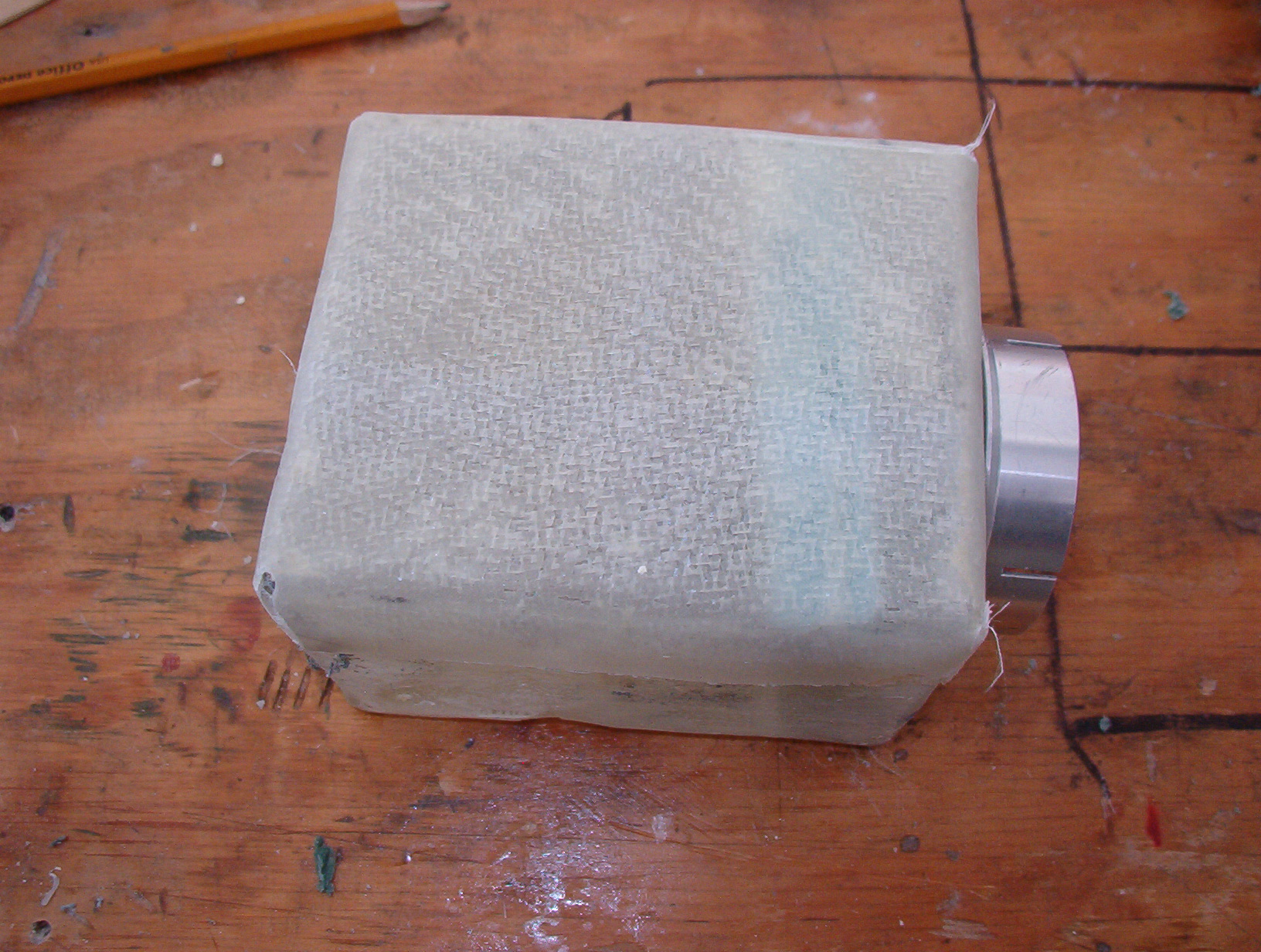

PostPosted: Tue Apr 12, 2011 6:05 am    Post subject: Re: JABIRU 3300 BRAND NEW OVER TEMPERATURE DURING TAXI Reply with quote
 Filesize:  798.26 KB
 Viewed:  12829 Time(s)
 Filesize:  787.76 KB
 Viewed:  12828 Time(s)
 Filesize:  785.56 KB
 Viewed:  12827 Time(s)
