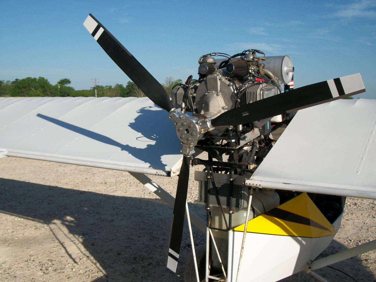

I am trying out a Warp Drive 3 - blade 64" prop on my Firestar. I flew it about 20 minutes this morning in "perfect" air ( 60 deg, low humidity, calm). My main reason for getting the Warp is I wanted a more durable prop.
I'm going to fly a few more times before I make an evaluation compared to the 66" 2 - blade Powerfin, but I will say the first flight #'s were pretty good. The prop was very smooth and had a more immediate response to the throttle than the 2 - blade.
My only concern is the HKS is similar to the Rotax "B" box in that it calls for a max. 3000 kg moment of inertia on the prop. I do not know what the MOI is for this prop and am having trouble finding anyone who does. I am aware of the measuring proceedure available from Rotax and CPS, just would like to find the info first rather than go through the exercise. Does anyone have any MOI data on their 3 - blade Warp Drive props?

From the inertia tests I did on a number of props in 2007:
Warp Drive 66" 3 blade CNC hub
Wt. 9 lb. 12 oz.
Average time to 30 oscillations, 180 seconds
Inertia 5200 Kg cm^2
I should add that this prop had bare, untapered blades. Can you use it as a reference for yours, probably, since it's unlikely that you're going to get to 3000 or under. Tapering will help, stainless steel blade guards will hurt. You might ask Green Sky, or whoever distributes this engine if they've come around to allowing Mobil 1 synthetic with gearbox additives. When Flight Designs was importing the engine they always told me absolutely not, just plain Mobil 1 5W-30. The only other thing you can do is set the idle RPM up a bit, say 2200 RPM minimum and run a magnet through your oil at each change. It you see iron shards it can only come from one place in this engine, the gears.

Jimmy, I didn't see the picture, sorry. Untapered blades and stainless steel guards, yeah, you're going to be pushing the 6000 kg cm^2 limit pretty hard. I think you can forget about getting anywhere near 3000.

Thanks for the prop MOI info. I do keep my idle up around 22-2300 even with the Powerfin. My HKS has never idled smoothly below 1900 rpm.
Looks like there's only one way to find out the MOI on this prop: I'll pull it off on Sunday & do the oscillation test. It's got my curiosity stimulated.
