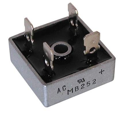

Guys,
Can someone point me to the right type and part no. of Diode to use in a circuit providing a dual power feed to a single piece of equipment?
I have an EIS4000 that has a single power input. I'd like to provide both E-bus power and an Aux Batt power feed to it.
I don't want the E-bus power backfeeding into my Aux Batt.

But if your heart is set on adding this feature
to your project, the bridge diode rectifier with
fast-on tabs like
http://aeroelectric.com/Pictures/Misc/s401-25.jpg
will do the job. Power to EIS comes from terminal
on the odd terminal set 90 degrees to the rest.
Power in from the two sources goes to the most
adjacent terminals. The terminal opposite the output
or (+) corner is ignored.
Suitable parts include Radio Shack 276-1185, B&C
S401-25, All Electronics FWB-252 and others. Any
diode assembly you can find that looks like this
will do the job.
