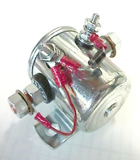

Using contactors with longer studs is the
general fix. When I was selling the S701-1
[img]cid:.0[/img]
I shipped it with thin, brass top-nuts but even with the
standard nut, the RBM/Stancor part had a longer stud
than the Cole-Hersey parts . . . and would generally
take up to 3 terminals.
Contactor posts are indeed preferred fan out
points for distribution of power but dealing with
the short studs on some contactors is problematic.
If push comes to shove, you can replace the bottom
nut with a thin "jam nut" and get some more exposed
stud. This is less risky with modern versions of
these parts.

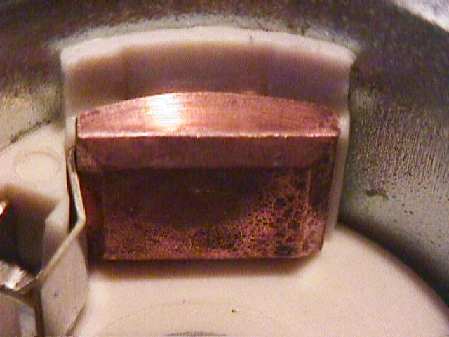

[img]cid:.1[/img]
The internal contact surface is held in better alignment
by bosses on the molded insulator. I may have a quantity of these
nuts left over from those times. I'll dig around in the
moving boxes as yet unpacked.
