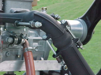

PostPosted: Tue Apr 12, 2011 5:22 pm    Post subject: Re: High Temperature Silicone Reply with quote
Dennis Thate wrote:
I'm looking for a High Temperature Silicone to use on my Rotax exhaust springs. Can someone recommend a product and supplier.
Spend a half a day modifying your exhaust and never worry about springs again. Buy some exhaust pipe clamps and cut off the ends where the bolts go through and weld those pieces to your exhaust. Pick up some 5/16" bolts at Lowes and drill holes in them for cotter pins. Get 4 stiff springs that will fit over the bolts and forget about silicone.
Once every 2 or 3 years buy new bolts because the old ones will chafe and wear grooves in them, but they will still be 1/4" thick. Even grade 3 steel 1/4" in diameter is a lot more reliable than brand new Rotax springs. Been doing this for years now, have almost $15 invested in it. Bullet proof. WooHoo!
