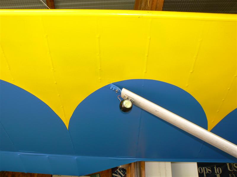

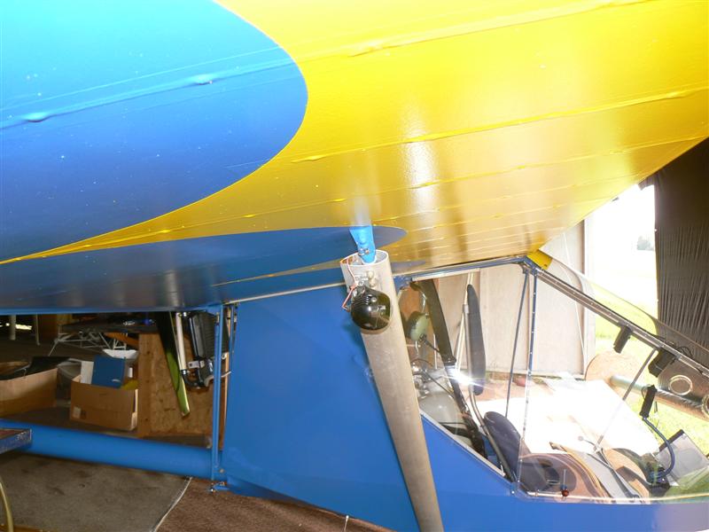

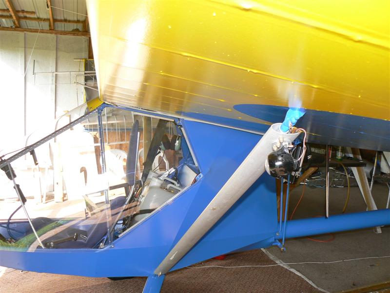

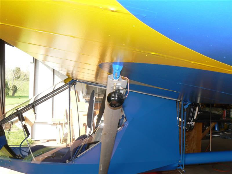

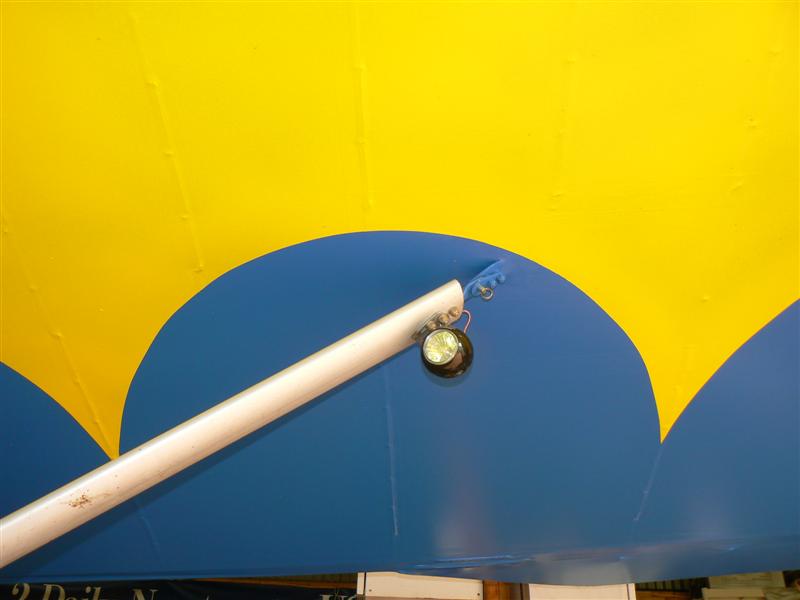

I would aim them forward, but that's just me. (BAD preacher, No! No!)
Ok, sorry, I'll try to behave.
Here are some pictures of the landing lights on the FSII, this was a sort of trial and error thing so that they work for landing and taxi. They are aimed so that they converge on the grass about 40' in front of the airplane when it is sitting in it's normal position. I would assume that would also work as an anti-collision light in flight, with each wing light catching the opposite side with a diverging angle.
Richard Pike
