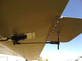

The Zodiac avoids aileron flutter issues by trimming
with a separate mini-aileron.
[img]cid:.0[/img]

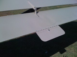

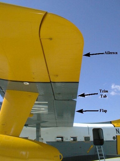

Other pictures of aileron trim tabs seem to illustrate
relatively small mechanisms
[img]cid:.1[/img]
[img]cid:.2[/img]
Also consider an actuator driven spring cartridge rigged
to the aileron controls under the floor boards. This
technique has been used by many designers with
success. You can develop your own design goals.

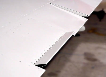

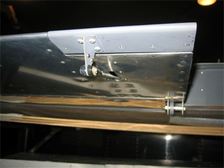

Joe
I'm using hardware designed for giant scale RC. The bolts are 8-32 and the push rods are 6 gauge rods. Your speeds are higher than mine, but remember that you require less deflection for the same result. Also we are trimming aerodynamically balanced surfaces and the air load on the trim tabs are a lot less than most expect. I have attached a photo of my flaperon servo installation. It is very effective and can induce a very high roll rate.
Jim
I'm happy to see someone (else) proving the naysayers wrong. This has been a pet project of mine for almost as long as you and I've taken a similar approach using a different controller (ATmega8). I'm even using a $18 servo to change the position of one of my landing lights for taxi.
Question, please: where have you found for a source of bellcrank, clevis, threaded rod and other hardware? I'd like to find some 10-32 but all the model airplane stuff I've found is pretty wimpy (4-40 or 6-32 at best). On my landing light the RC stuff is OK but I'd like an "aviation grade" mechanical coupling for the elevator and aileron trim on my RV.
Joe
Independence, OR
