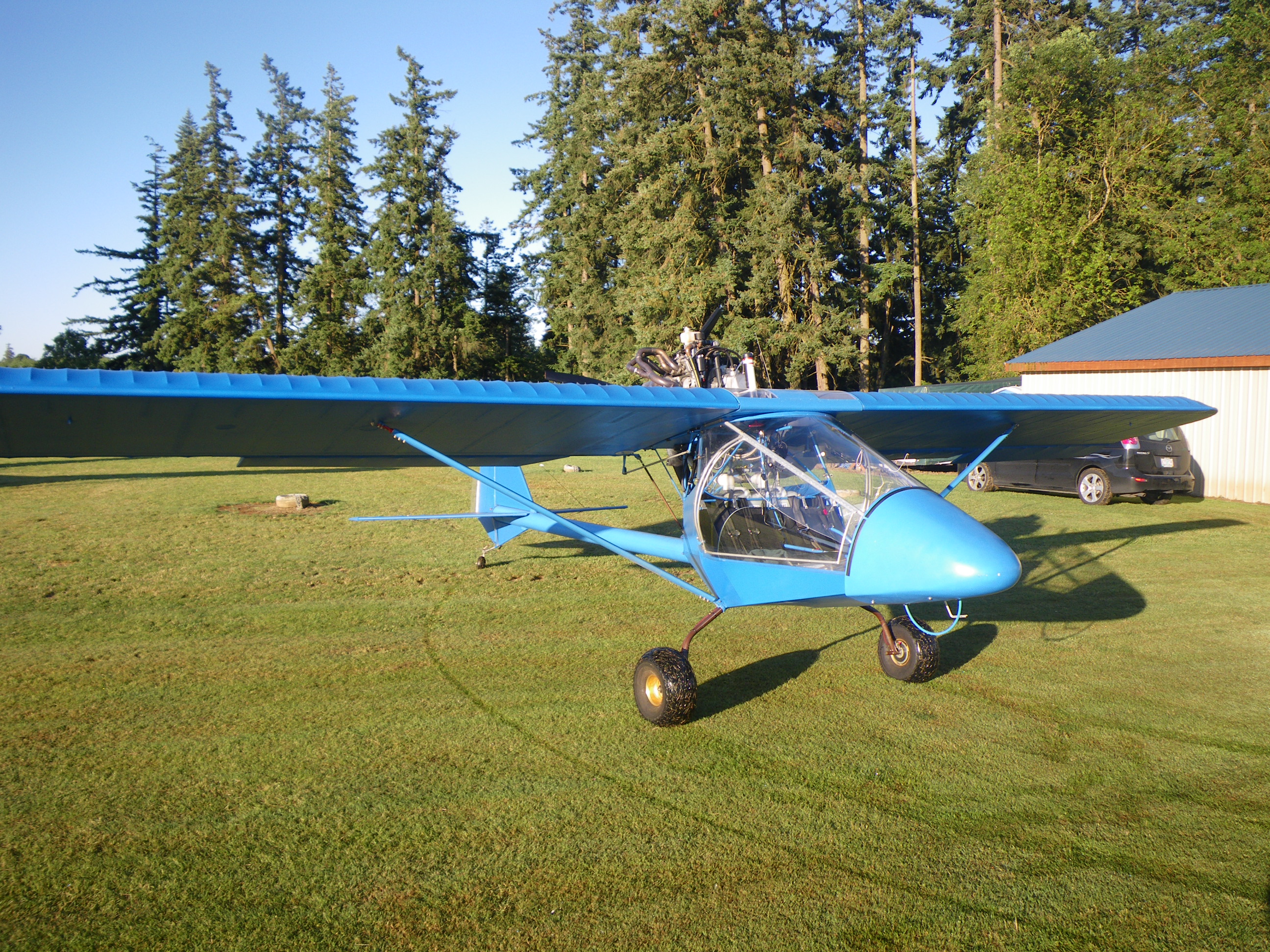

When I slightly bent my aluminum gear, I just unbolted it and turned it 180 degrees in the socket so it was now slightly bent down.
Attached is a picture of my MKIIIC with a steel gear made to John H specs.
