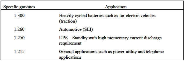

I wasn't too clear on that answer. Consider this chart
taken from one of many tomes on batteries;
Specific Gravity Readings – “True” State of Charge
The specific gravity (SG) of the battery acid or electrolyte is the truest and most absolute measure of a battery’s state of charge. The SG reading is NOT greatly or adversely affected by the load on the battery. Basically if a battery is 50% charged, it will read a specific gravity of 1.200 (see Table 1), regardless of whether the battery is on charge, being discharge or being stored. This is not the case for voltage readings.
Table 1. SG vs. Voltage
% Charged Specific Gravity
100% 1.255 – 1.275
75% 1.215 – 1.235
50% 1.180 – 1.200
25% 1.155 - 1.165
0% 1.110 - 1.130
Notice that here is a 'range' of values
that can represent state of charge for
any particular battery with a delta of
20 points out of 1300. Other books may
differ to some degree . . . for example:
Specific gravity does, of course, vary with temperature and the quantity of electrolyte in a cell. When the electrolyte is near the low-level mark, the specific gravity is higher than nominal and drops as water is added to the cell to bring the electrolyte to the full level. The volume of electrolyte expands as temperature rises and contracts as temperature drops, therefore affecting the density or specific gravity reading. As the volume of electrolyte expands, the readings are lowered and, conversely, specific gravity increases with colder temperatures.
The specific gravity for a given battery is determined by the application it will be used in, taking into account operating temperature and battery life. Typical specific gravities for certain applications are shown in Table 1.
[img]cid:.0[/img][/i][/b]

and if that knowledge is important (poking holes in clouds
or long trips over unfriendly terrain at night).
I certainly do appreciate your ongoing input and expertise about
anything electric on the Matronics list!!!
My pleasure sir.
