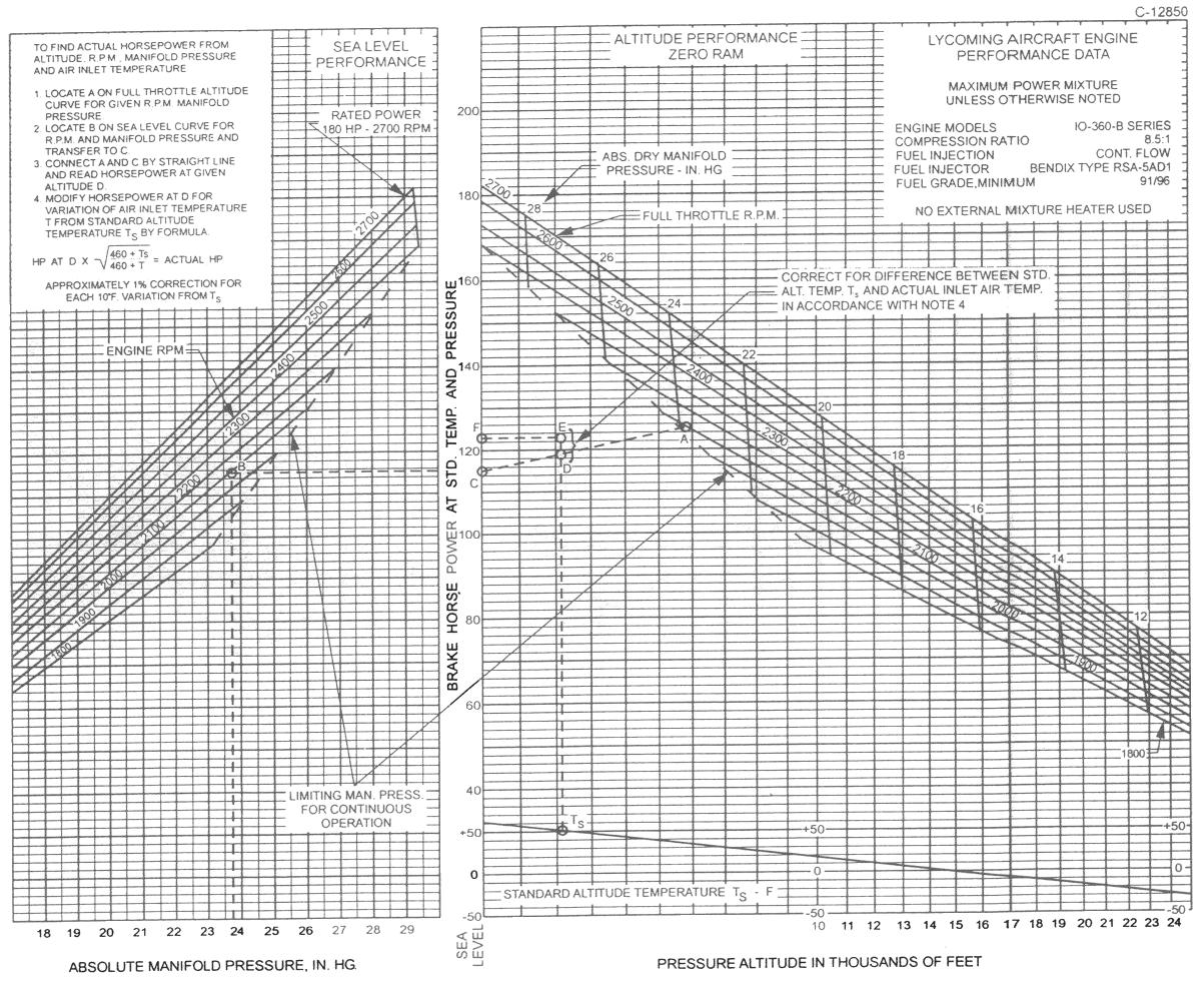

Hum, interesting. In that graph, albeit for the IO-360, the "Limiting MP For Continuous Ops" at 26 MP is 2100 RPM. 27 MP is 2200. Assuming the IO-390 is similar, 2150 at 26.5 ought to be good to go. BTW, I flew tonight and at 26/2150 I was seeing about 10.2-10.5 GPH (at) 2500ft. Better than I recalled.
Where can I get a sweet chart like that for my IO-390? I looked quickly though the manuals that came with the engine, and I didn't see one.

At 10:07 AM 3/31/2011 Thursday, you wrote:
[quote]Matt,
I don't have an IO390 but the manual for my IO360B shows that combination as outside of the suggested area of continuous operation - yes it was a quick look and I didn't purely run the numbers.
I would guess that combination might be detonation-prone.
YMMV - see if you can get the appropriate chart for the IO390. They are a bugger to figure out too - but there are some guidelines.
Ralph
